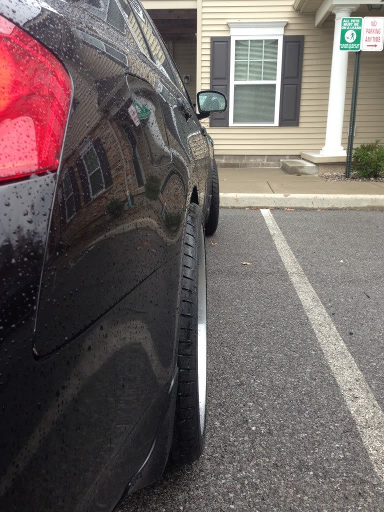

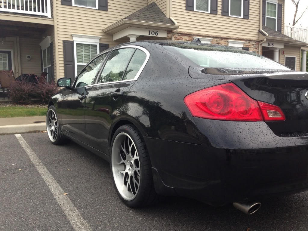

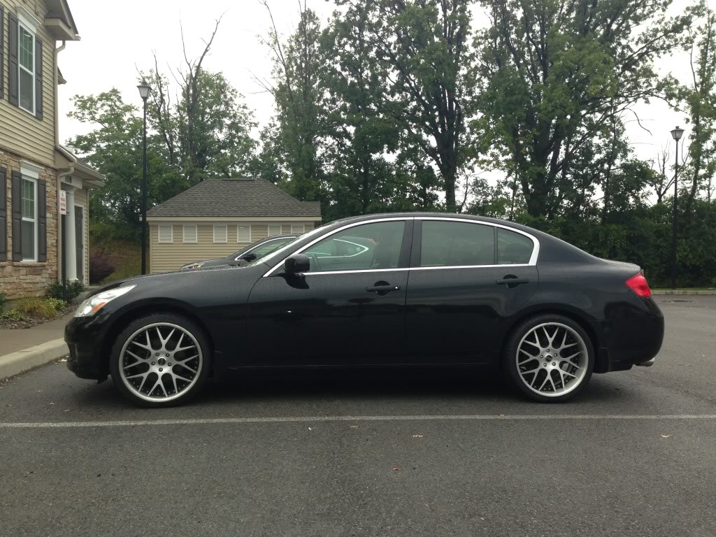

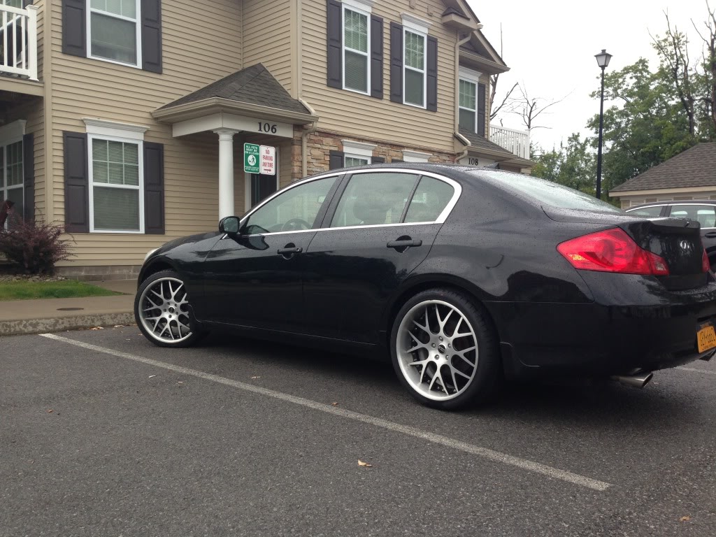

Had a chance to get these installed the other day and figured I would upload some pictures for everyone to see. I am slightly worried about the poke in the rear, it's more than I expected, but we will see how it tucks when the pro-kit is installed. Let me know what you think (I know it needs a drop).
Do you think this will rub when I drop it? I'm a little nervous about it rubbing, especially after all the research I did it would be brutal if it didn't work without crazy camber.
Does anyone know if the g37x has the same fitment for wheels as the g35x? I figured they would and that's the reason I went with these specs because my 20x10 +40 should be almost identical to 20x10.5 +45 according to online calculators. Hope it will all work out for the best, opinions/predictions welcome!!

Brutal honesty is my policy so here goes. I do like the wheels but don't know anything about the brand. Even though you say you did a lot of research it seems like you still didn't really know what you're getting into. I would have gone for a skinnier tire in the rear which would have given you more room to play with as far as tucking tire goes. Not sure what kind of drop the Pro-Kit gives on a 2nd gen X, but you're going to have to run a decent amount of negative camber to clear the fender, my guess is more than -2*. Your tires will naturally camber in when you drop it so that will help but you might need at least a rear camber kit and definitely some kind of aftermarket toe kit to get you back into acceptable alignment specs. Also check your fenders for clearance, I know the 2nd gen came rolled from the factory but if you end up rubbing at all they might need to be flattened. I'm curious to see the outcome of the drop so keep us posted and good luck.
