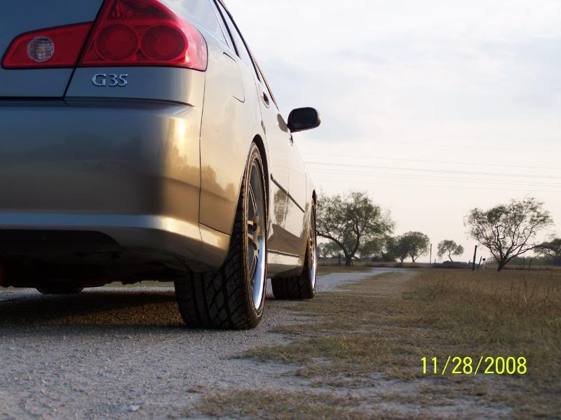

So currently, my 2003 g35 sedan is lowered on H&R springs and i am upgrading to 19 inch wheels as opposed to 17's... i am wondering if a 15mm offset will still clear the fender or would i be better off going with a 35mm offset? QUICK reply needed! Thanks!

I had 245 40 19's on 8.5" rims that had a +30 offset and they were right at the back fenders without rolling. 15 will not fit.

The tire I'm getting is a 245/35/19 and the wheels are 19x8.5.. Are you sure?

Yes, I ran a little bigger tire than you and it fit perfect.
Here is a pic or two:

Mind you, these were taken before I lowered it an inch.
Below is after:

Okay, sick.. It's looking good! I'll just go with 35mm offset then to be safe!.. Thanks man
