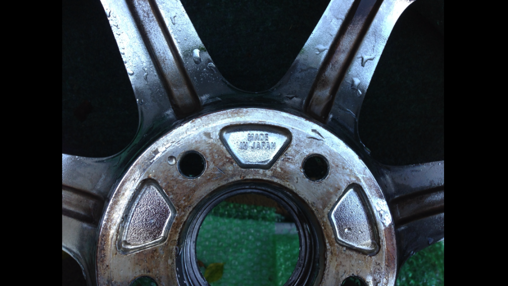

These are Bolt on spacers right? I had trouble getting my off as well after being on there several years. If I remember correctly, your wheels need to be able to accept the extra stud length beyond the spacers.
These were my rears and had no space, so I couldn't use those because the studs hit the back of the wheel. The fronts were deeper and worked fine. Point here is don't use extend studs unless you know they will clear the back of your wheel. I think that Ichiba just sucks and those nuts get welded on over time due to heat.
