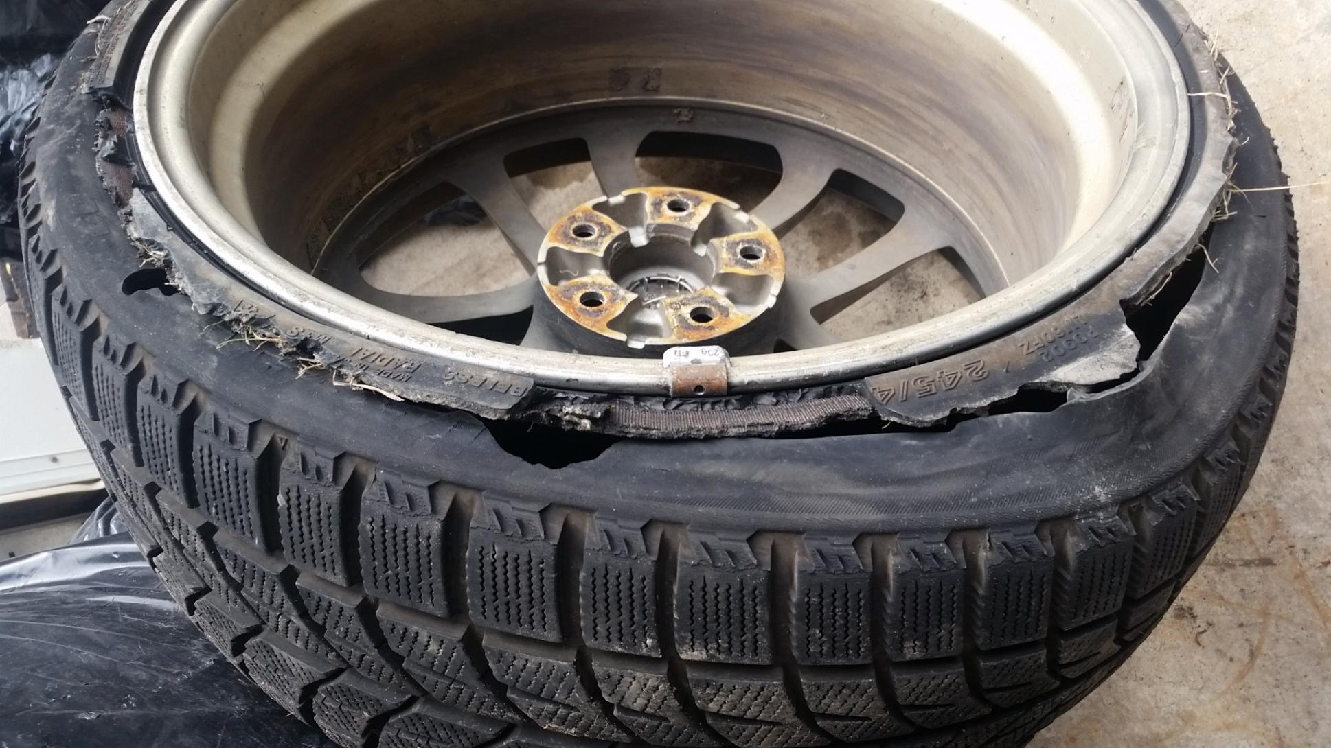

Hey guys,
About to pull my hair out with this one. Since a couple years back, I've blown maybe 6-7 brand new tires on these wheels. I already replaced two wheels because of it and I've forgotten which tires and wheels I've replaced lol.
I had my car stored this winter and took it out on the road, second day, tire blew up on the highway, brand new tire. I took a pic and the tires have all blown the same way...the inner tire rips right out all around. I'm assuming this rim is bad too. All tires were inflated, none were low on air.
Has anyone ever in their life seen this or had similar issues with the OEM 19s? Just wondering on what peoples thoughts are on this bc I've been spending a ton of cash on tires lately.
Pic attached.
Thanks!

what brand and model of tire do you get? are you lowered? do you carry a lot of **** in your car (I.e. overloading)?

They are Bridgestone Blizzak LM60.
OEM Sport Springs - Tokico Struts - Camber kit installed and adjusted on the rear.
No load other than a couple subs in a box in the trunk.

How much camber angle?
If its ripping from the inside of the wheel well then your tires may be rubbing on something. Are there any weird noises when your are driving from the tire area?

Are the tires over inflated? What PSI are you running? Do they blow out after being stored for the winter? If so, there may be a problem with how you're storing the vehicle. Where do you live? It's a little late in the year to be driving around on winter tires. Have all the blow-outs been from the same model tire, or have you tried different brands?
