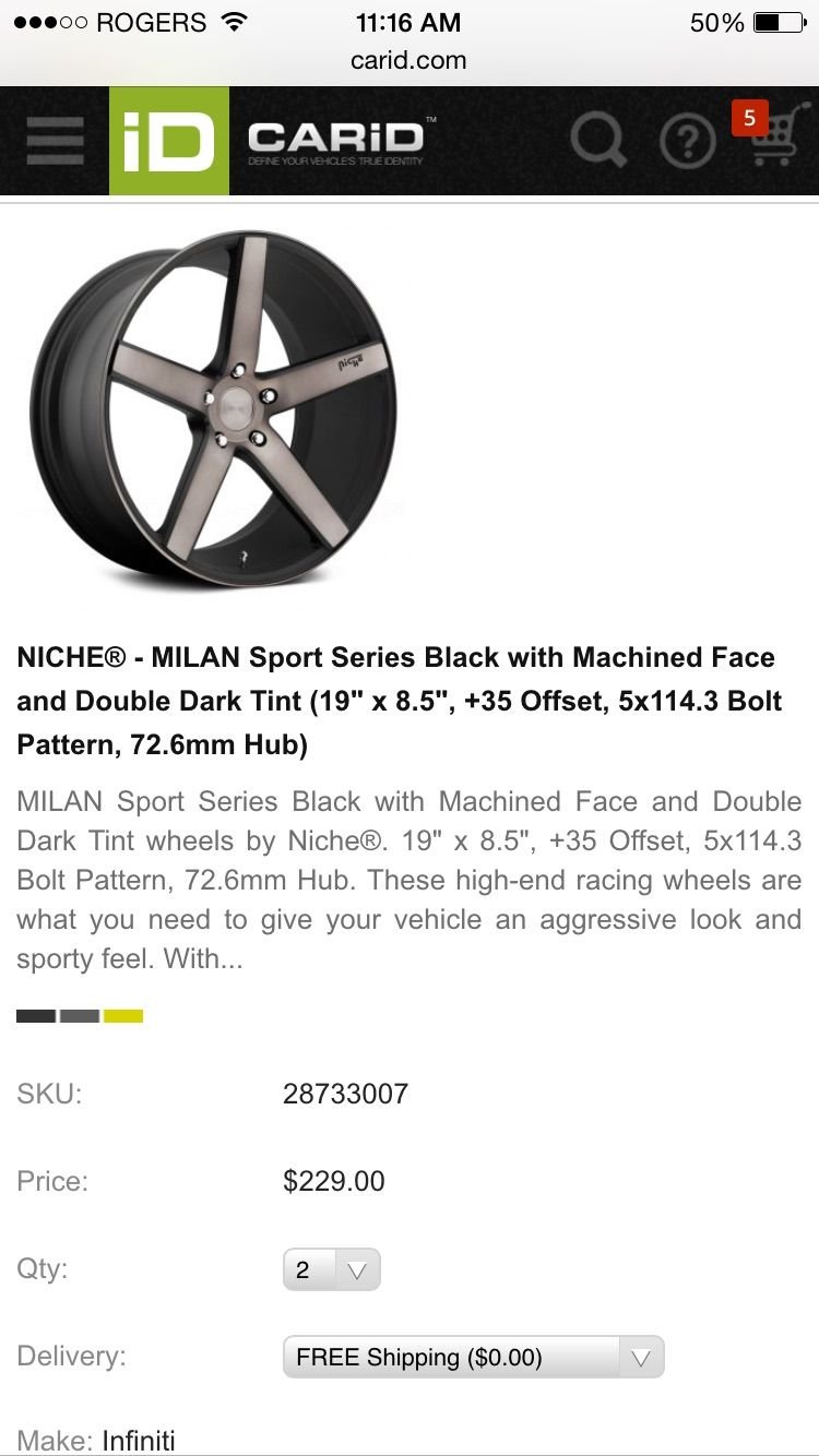

Hey guys, so i've decided to get a set of the Milan Niche rims. However i dont know if the rim sizes and offset would look right with the ones i am going to be ordering. Here is the site im getting them from with the specs on the wheels - http://www.carid.com/cart.php
Would this look good on the G with the specs those rims have? btw i have stock suspension.

Ok then. Here's some pics I attached with the specs. The rear rims are the exact same spec except they have the option of either being 8.5 or 9.5
what car?
Coupe?
Those are more sedan offsets...they are no where near appropriate for a coupe

06 coupe

Those will be incredibly small. Assuming your car came with the forged OEM 19" rays, which will be a reference point here, these will be just as sunken in and in terms of quality, a huge downgrade.
But back to specs, you want something in the 9 or 10 width up front and 10-11 out back
Keep the offsets in the teens to low twenties
.If you want to try your stance pants on, then drop the offsets to single digits and continue into negatives.
For a well fitting wheel keep it to what I to I originally said
Should you plan to ever have a BBK ensure their disk size is appropriate for such

Also, seeing as Car ID has already tried to sell us spyder headlights as quality, it makes complete sense Niche wheels are described as "high end racing wheel"
