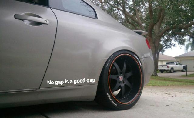

I'm running 285 35 20 on a 10.5. The only rubbing is on the rear bumper bracket so it has not much to do with the width and more so to do with the oversize tire diameter. 30 profile would suit better but this is what I had available at the time. It doesn't actually touch anymore though at the current ride height.
285 is the perfect size for 10.5 inch wheel, the Michelins have quite a chunky sidewall compared to stuff like Falken/Nankang but there is still no bulging of the sidewalls or anything.
The camber I have is natural from the drop and no extra camber was needed for clearance but the fender had to be rolled to accommodate for the quite aggressive offset of the wheel. It's definitely worth rolling the fender for clearance as you'll easily get another 10-15mm space and maybe a little more with a slight pull.

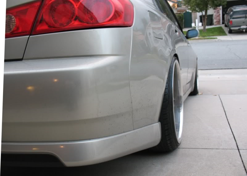

I think 19's are perfect but that little extra tire cost pushes me to 20's to be honest. Pic I'm copying below was from "G Sedan" in 2009 on here running a 295/25.20 but that's a tad to small in height for me. I will run 285/30/20 or 275/30/20 both are 26.5 to 26.7 in height and that's in the rear. I probably will go with a 245/35/20 on 8 inch wheel in front. Wheel size isn't an issue for me to figure out once I figure the tire I want to run. I've always been happy with a 275 on a 9 inch rim and 285 on a 9.5 to 10 inch wheel. I think I will stick out a tad more than you do with the Coupe. Looks great but I think a 1 finger gap to 1 inch gap is perfect for me at my old age of 35 years
Pic is not mine, G Sedan is the member who posted it but my inspiration and can't really find anyone else whos done much like it.
Attached Thumbnails G Sedan 285-295 rear tires - Experienced chime in-295-20-g-sedan.png
