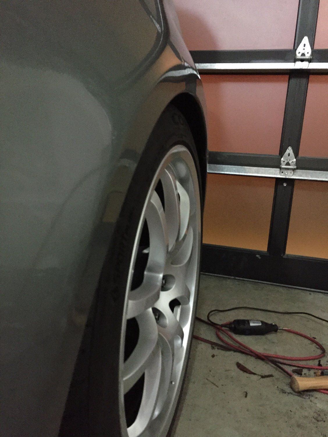

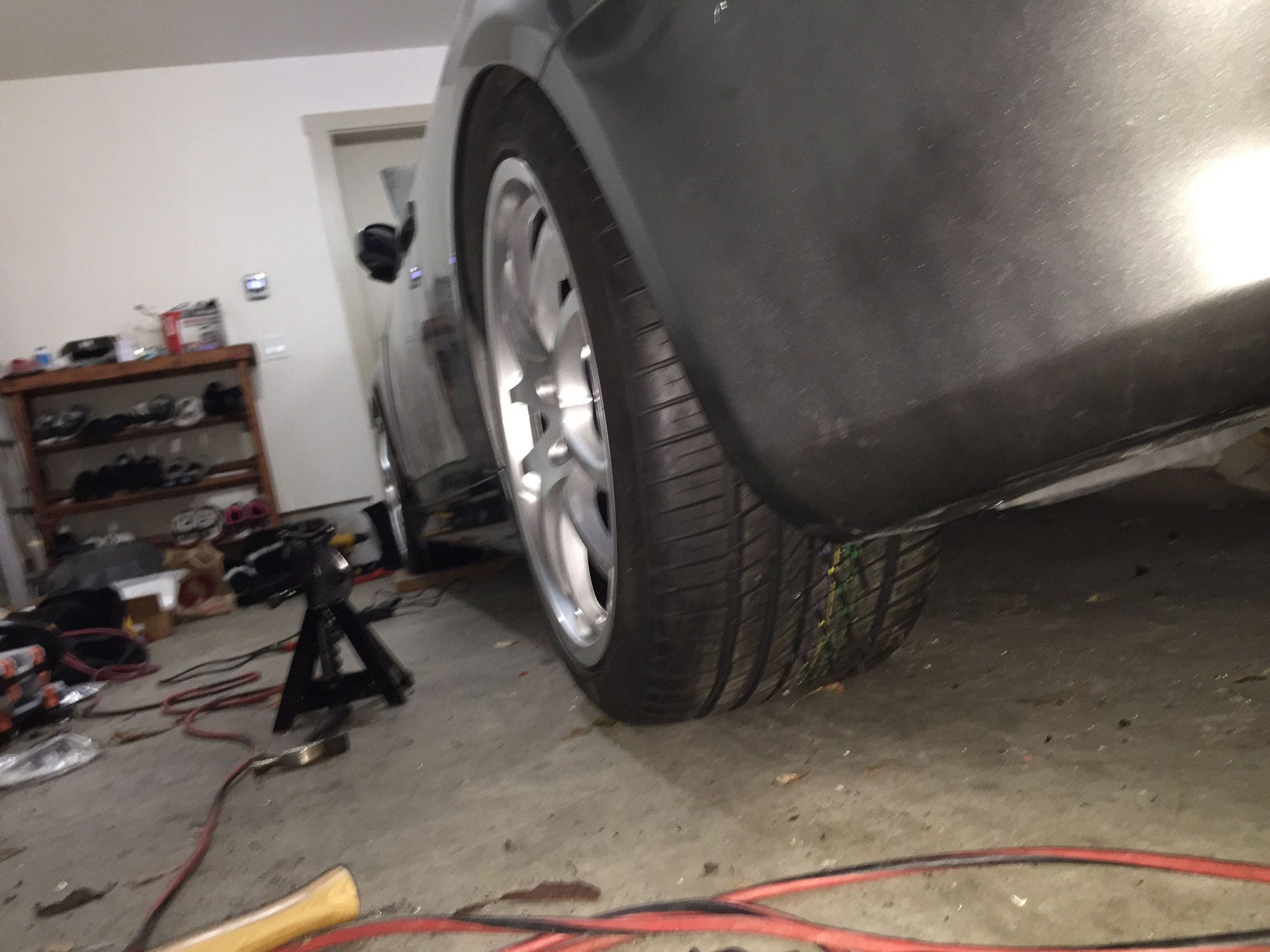

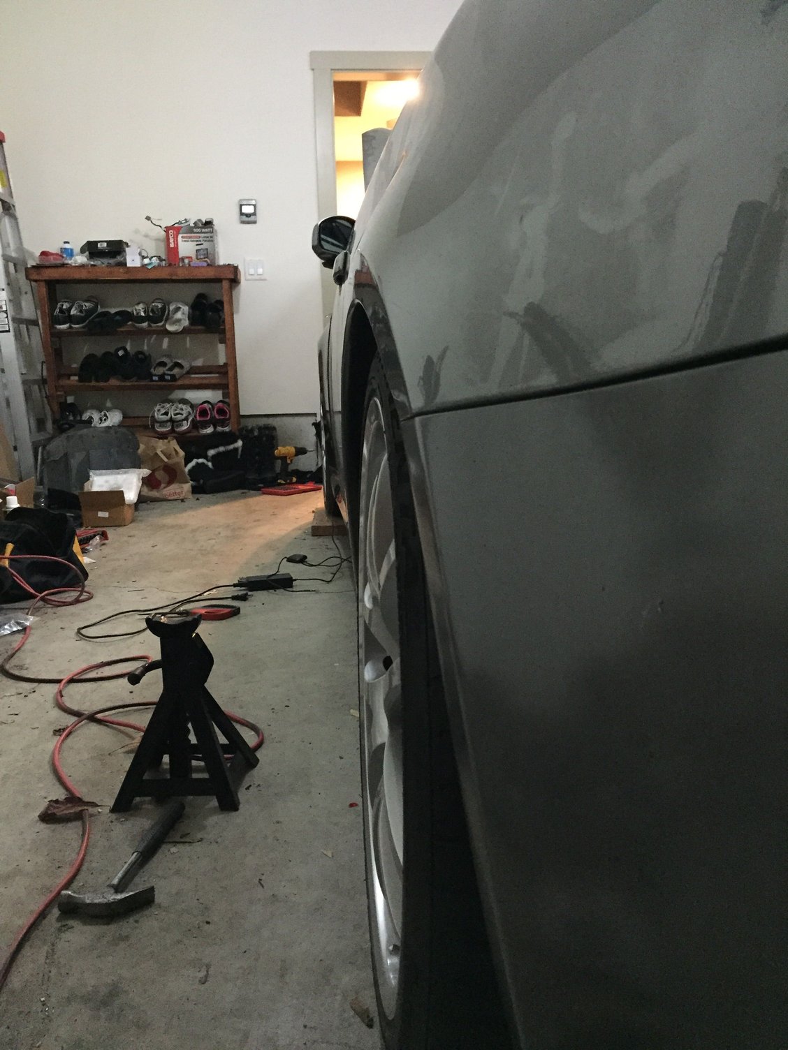

correct, the offset is now crazy high, but the only thing that matters in regards to having it sit flush is the distance from the the mounting disc to the outside which is never changed because the added band was added behind the mointing point, so a 20mm up front and 25mm in the back is a flush fitment. and the plus side is its basically at stock offset so it shouldnt be any additional strain on the bearings. the only thing that one needs to be weary of is if you have enough clearance to the knuckle arm, which there is plenty of, it barely fits with no spacers, so with a spacer it fits fine
Old Dec 3, 2016 | 08:25 PM
.cakestar's Avatar
Posts: 1,786
Likes: 178
From: Seattle
might be hard to tell but there is a little neg camber from my 20"s i had on there before so after i get an alignment they should be flush. just had the rears rolled

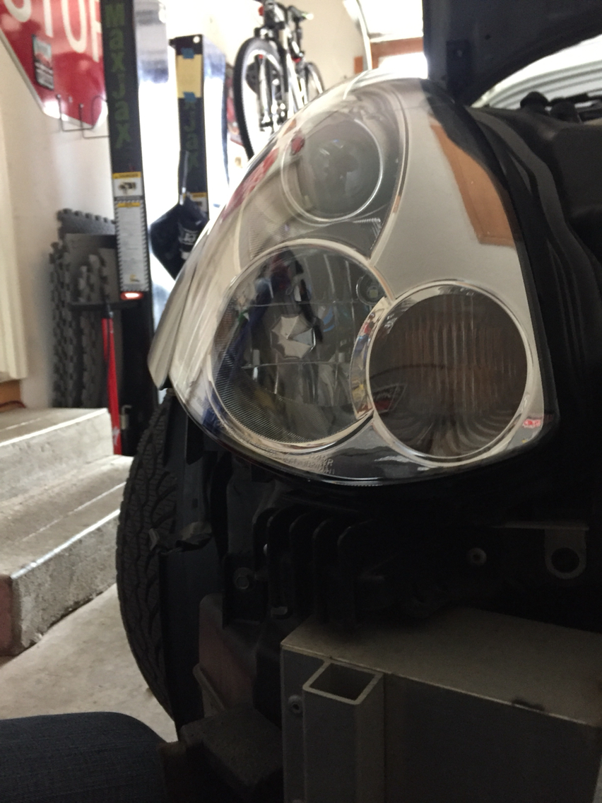

Get an LED in that turn signal... the amber is so ugly.
