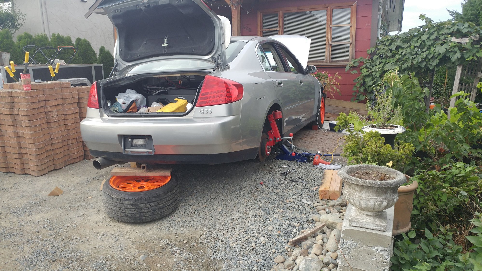

Bought a set of wheels which are XXR 521 18x10 +25 for the rear after members on here told me it will not fit.
the fronts are 18x8.5 +30 i think and fit prefect.
So now i am stuck with the wheel,which pokes out of the fender.
my question is,how do you guys pull fenders to clear the wheel and tire?
Before i F UP anything else.

Post a pick of the overage and we can tell you whether a pull would work or not. You can pull yourself with a roller you can rent.
....be aware that people royally screwed up their fenders all the time trying to accomplish pulls/rolls without properly heating.
I cracked my paint on the underside because I got impatient on the second fender.

Camber or pull. Your not really that low so just a little camber should work if your already rolled.

i havent rolled yet,i thought about cutting and pulling.
Goal is to run 265/35/18.
So i was thinking about cutting and pulling.
Wanted to ask your guys advice before i do anything else.
Regarding damage to paint....i am ok with that,the car is my dd work car/grocery getter so a little paint damage is ok.

Whoa... I would let a professional handle cutting or pulling.
What's the problem? Are you rubbing?
If your doing it for looks your going to need to get lower. No amount of camber or pulling will make that look right.
I think with a roll you shouldn't have an issue

Roll can be done with no issues, just take your time. If I was you I would run a little neg camber and drop it more.
Actually after looking at it more it would be hard to pull that off with 18" wheels. Might need to just bite the bullet and go 19-20

u can rent one. Make sure you use HEAT HEAT HEAT and go sloooowwwww. You will get impatient and start to get agressive but just take your time.
Also, I'm not sure if you will be on a lift or not but I had to be in neutral to roll the rears so keep that in mind.
Good luck! Post up some pics when you get it done.
