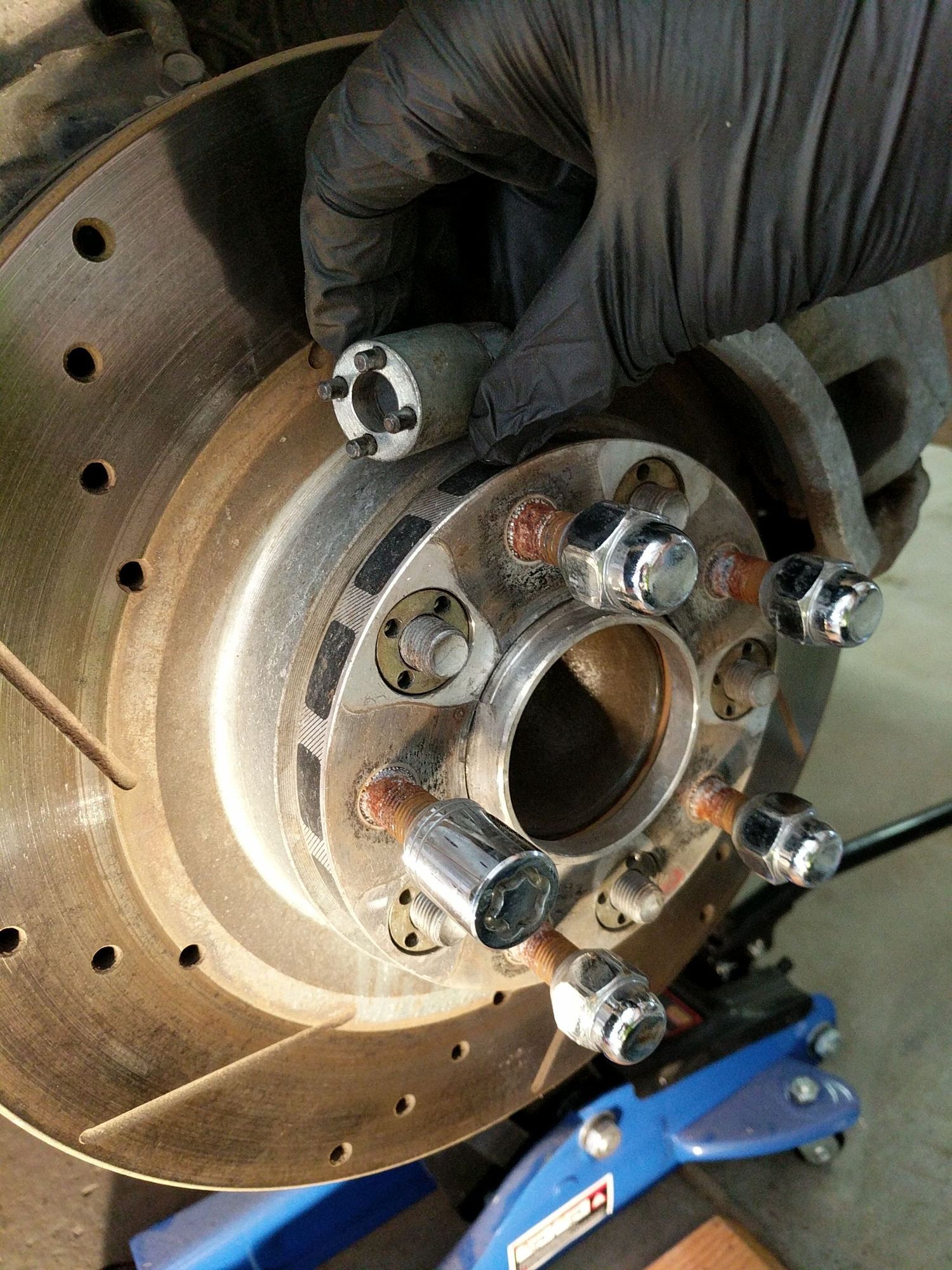

Here's a picture of the 15mm on the front of my car, small spacers like that typically use a recessed head design like this.

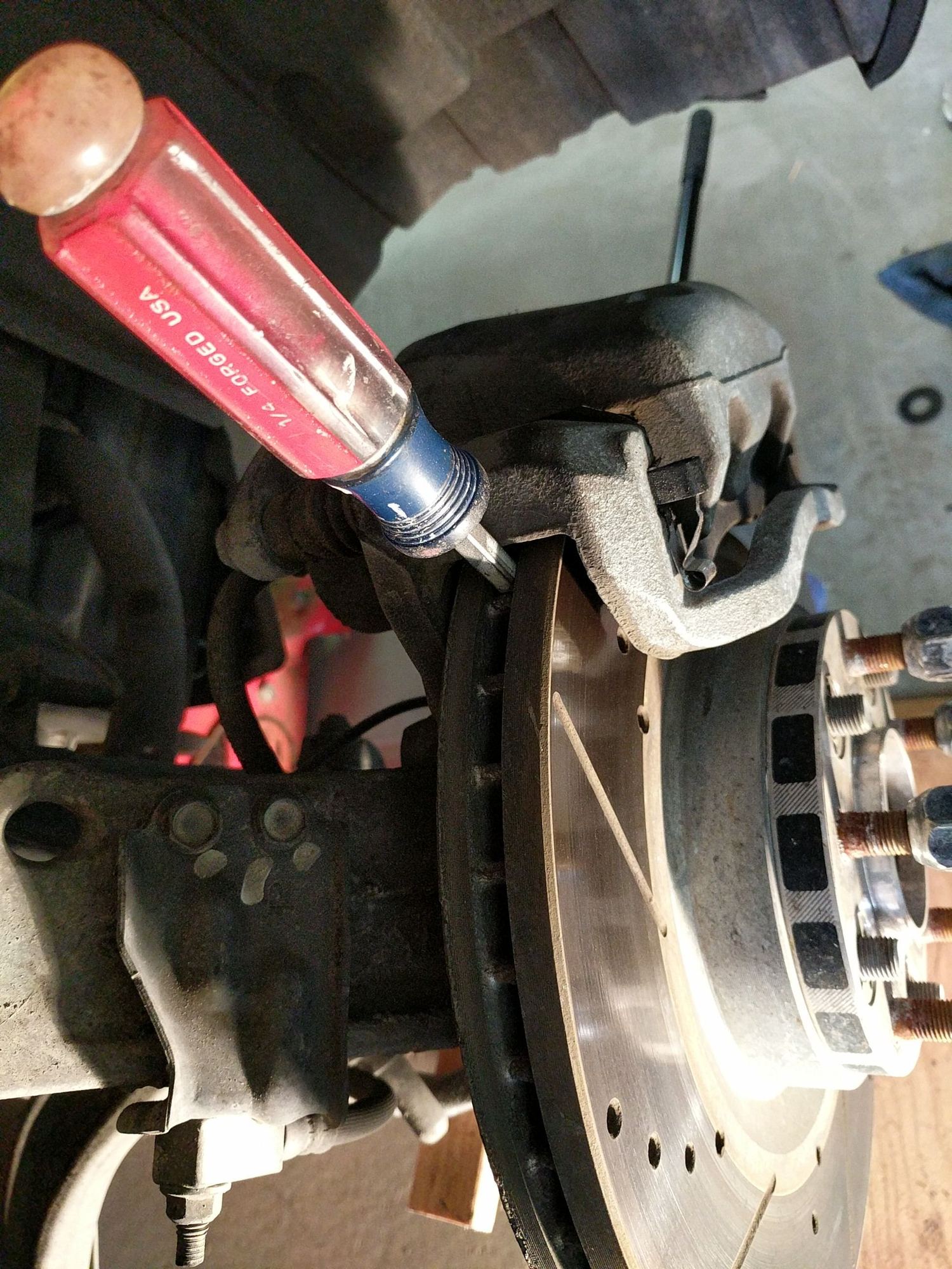

In my experience the only time spacers like this are a problem is from people not properly torquing them down, here is my preferred method to keep the hub from spinning.
