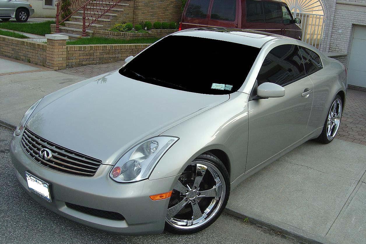

Im 99.9% sure that the actual rims would fit and not rub unless I was really driving hard but offset-wise and such...would they fit and sit close to flush with the fender?
I used to have 20" Chrome Zenetti Fives (20x8.5 with 245/35/20 and 20x10 with 275/30/20) on my Desert Platinum Coupe but sold them because it is time for a change. Dont get all crazy on me with the BLING BLING thing, I like big rims (and no I dont want an escalade), and to each his own.....Any educated responses would be very much appreciated as to fitment...thanks!

If they are "dual drilled" (5x112 / 5x114.3), then the bolt pattern will work. Believe it or not, the G35c runs a more aggressive offset than the S-class Mercedes, so they will probably be "inset".

so how bad would the inset be? would they be ridiculously inside the fenderwell (in the rear especially)? or more like barely noticable? since the s-class has around a 30mm offset, what do you think....

Without knowing the offset spec, I couldn't tell you however, its no way to get around the rear wheel being inset when you use the same sizes front and rear, this is especially on a G35c (since the rear is so much more aggressive).
If you cant do 21", maybe go custom made 20" with really aggressive offsets to get the spec right to the edge, which would honestly look better than 21" non staggered.
Heres a nice example (and the G gets these type of lips too)
