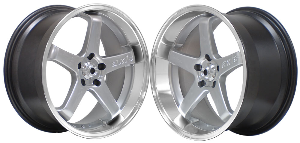

Long time lurker 1st time posting. I searched but came up with mixed results. I am ordering Axis Hiro in silver 19' and was wondering if I could use the stock 19" rubber? I also cant tell if the correct offset is +20 for the 06 coupe or or +35. I am ordring 9.5's for front and back. Could some one clarify for me these questions? (Will stock rubber work?+ What is the correct offset for the 06 coupe (+20 or +35)? Thanks in advance.

It looks like the correct fitment for a staggered setup is 19"x9.5"-25 front and 19"x10.5"-35 rear. If you have Brembos or big brakes, you'd better confirm they'll fit. Good luck!
http://wheelstudio.com/catalog/wheels.php?
vehicle_make=Infiniti&vehicle_model=G35%20>%202003-&mw=9&d=19&bp=5x114.3&let=25&het=31&hb=66&t1=24 5-35r19&t2=245-35r19&t3=255-30r19&staggered=yes

Sorry, I didn't mean to imply negative offset. I used "dashes" for the offset, which in hindsight was a poor choice. I should have described the fitment like this:
19"x9.5"+25 front and 19"x10.5"+35 rear
If you look at that link, you'll notice you can also get 8.5"+35/10.5"+35 or 8.5"+20/9.5"+25 staggered setups. Again, I encourage you to talk to an Axis dealer. If they can't answer your questions, you need to find a dealer who can.
