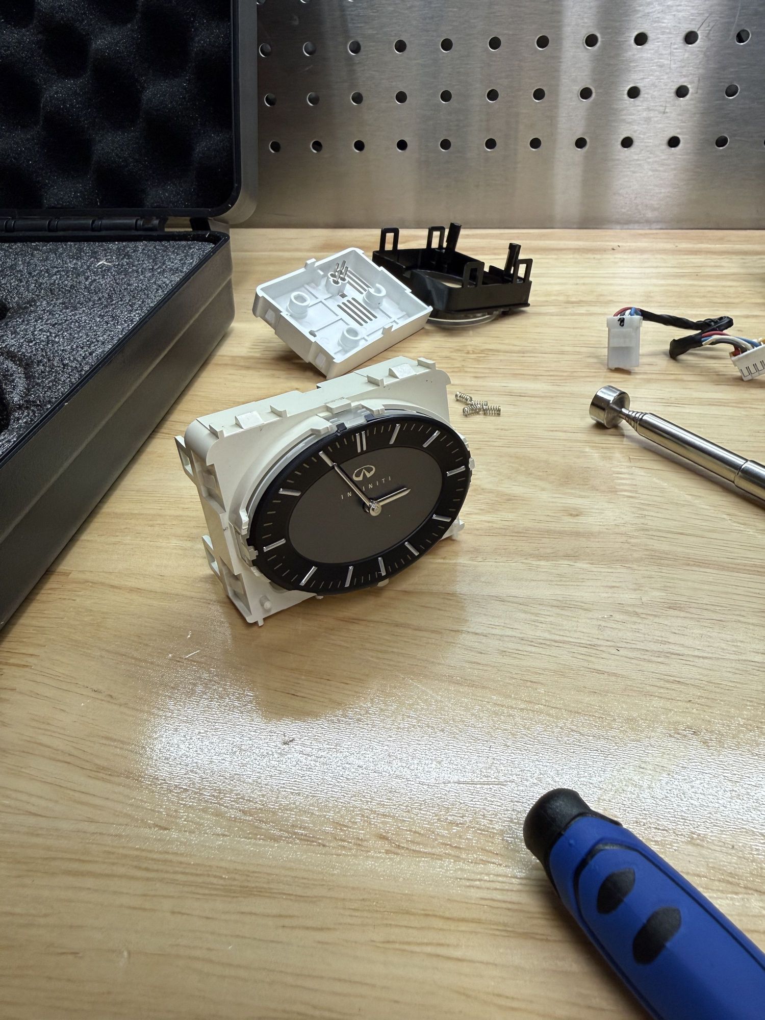

This is the 05-06 Clock. I took it apart down to the circuit board hoping to be able to fix it but unfortunately you can't fix them. there is 6 prongs on the board and there are 8 copper wires that have to touch the prongs to give the clock power. Over time the copper wires vibrate their way out and become disconnected. I don't really have the time to figure out a 6-digit password and I'm not sure anyone else does so I'm going to say they are not able to be fixed
