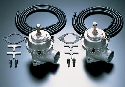

Originally Posted by sweettalker
I do indeed have vortech. I am running HKS bov on it.
HKS BOV? or do u mean HKS bypass valve like the one in this pix?
Old Mar 12, 2009 | 11:46 AM
  #20
cwylie's Avatar
Joined: Jun 2008
Posts: 200
What needs to be modded to use this valve?
Old Mar 12, 2009 | 02:17 PM
  #21
istan's Avatar
Joined: Jul 2007
Posts: 597
From: Las Vegas
Here is wiki definition:
NO
From HKS- A slightly more reputable souce than wiki.
HKS Standard and Racing Bypass valves are push-type valves that utilize calibrated spring rate and vacuum line pressure to remain closed against the pressurized air in the charge pipe.
The New HKS Super SQV Racing blow off valve is a pull-type valve for high horsepower applications
The difference is how the device works. A BPV remains open at all times, unless under boost. A BOV remains closed at all times, unless under vacuum. So, a BPV's state is changed with the introduction of Boost and a BOC's state is changed with the introduction of Vacuum.
The Vortech BPV (Blue) is not designed to recirculate, but rather vent to atmosphere. It can be changed to recirculate to the non pressurized size, ie before blower, but doing so does not change the inherrent nature of the BPV.
