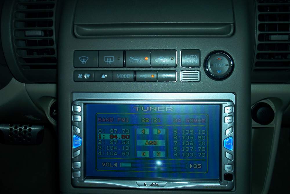

I'm ready to make the double din conversion. I've seen that the AC controller from Grubbs has black buttons. I have the willow interior. Is it possible to simply exchange the buttons onto the new control? I know I'll have to solder to retain the dual climate control function.
Old Jun 18, 2006 | 08:24 AM
HipHopPro's Avatar
Joined: Dec 2003
Posts: 866
From: Brooklyn, NY 2 Orlando, FL
Yep, It's possible, I did it.
Attached Thumbnails confused about this double din stuff :(-ddin_2.jpg

question, do you lose the features of dual climate control with the double-DIN switch? I notice the "Dual" button is blank on your swapped AC controls.
Old Jun 18, 2006 | 06:56 PM
BigSash's Avatar
Joined: Nov 2005
Posts: 1,775
From: LA, PDX, & Everywhere between
man if you have dual climate control you can transfer the button from your old controls to the new ones but this requires some minor saudering, I am sure your installer can do it if you can't.
otherwise you lose the DCC.
