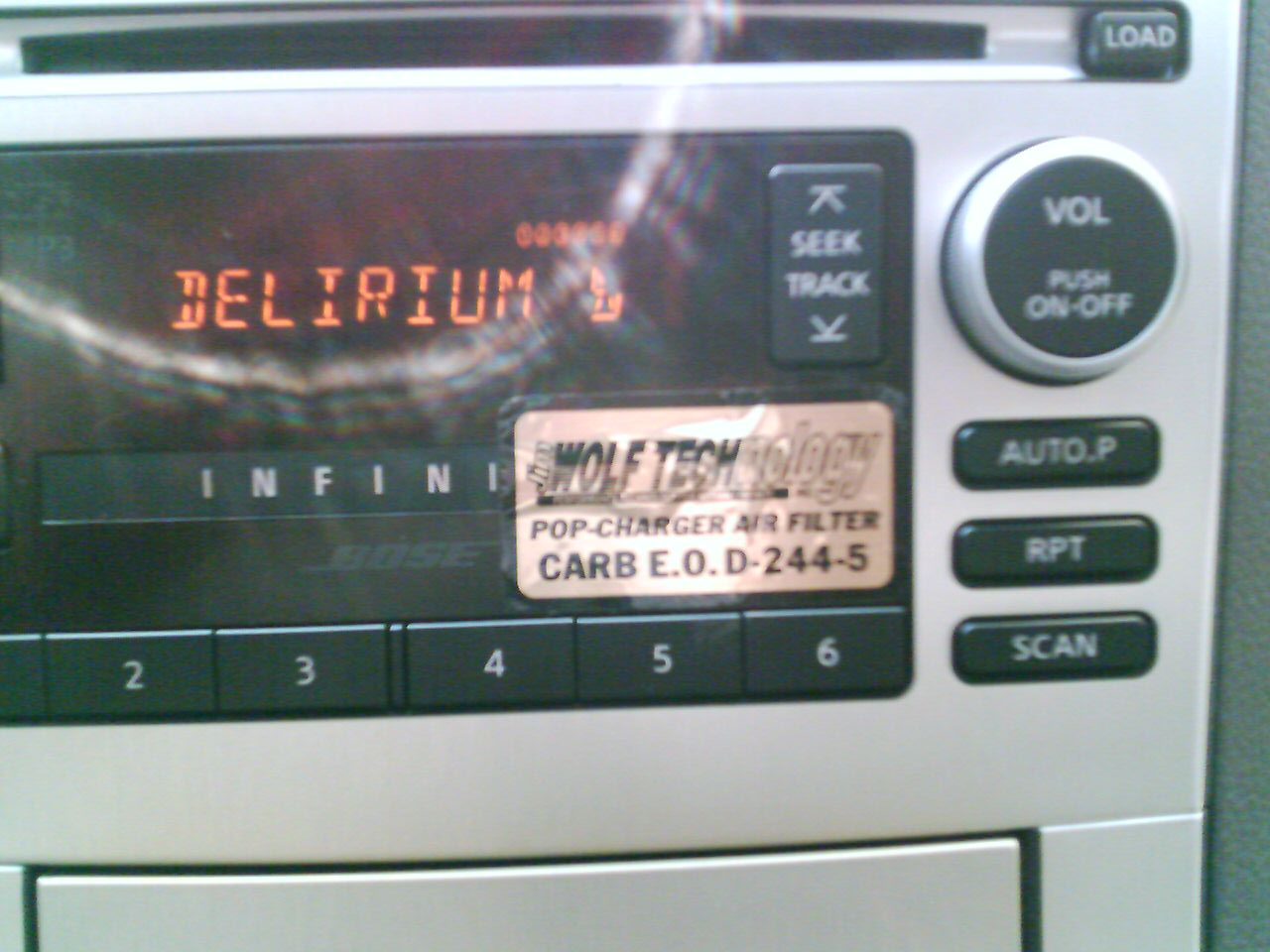

For you g35 owners, as you know, there is a hard Infiniti label on the stock audio plastic face. Below it says BOSE.
anyways my label was peelingoff on the right so i thought id use super glue to fix it. Anyways i did but some glue ended up on the plastic and now there is a white mark. i tried acetone/soapy water with no success.
I cant stand the white mark so i just put my JWT sticker on there.
Is it possible to order a plastic face only?

is it on the clear part or the painted part?
did you try using Zippo lighter fluid?
if it's on the clear part you can sand it down with a high grit sandpaper, 600 or higher will be fine. I like to use 1000-1500 on plastic parts. then use plastix (sp?) plastic polish. the sandpaper will remove any glue residue and the polish will remove the fine scratches left behind. wet sand, btw if you do it dry it's to aggressive.

3M Adhesive remover

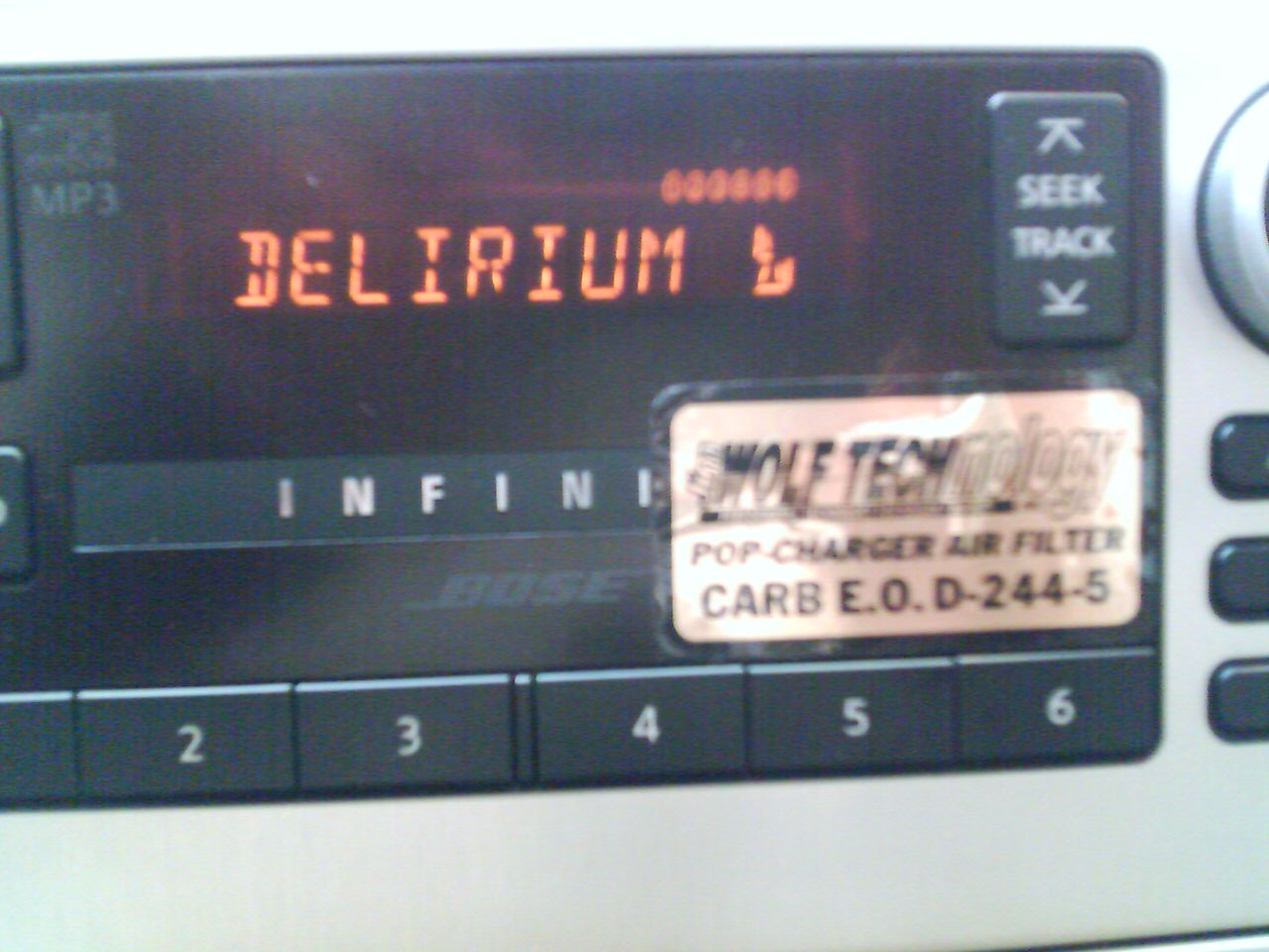

here's the damage. i have to cover up with my JWT sticker.
