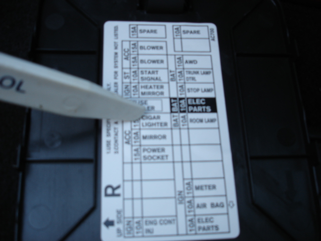

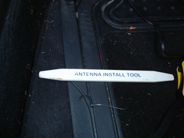

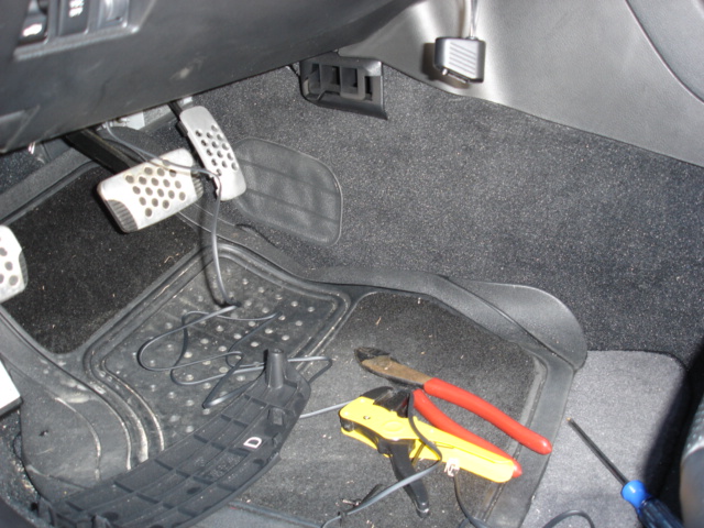

Step 1. Items needed . 9500I, DWSC (Direct Wire Smart Cord)wire crimpers,wire strippers, wire ties, wire connectors, basic phillips head screwdriver, non scratching tool to tuck wire(antenna install tool) and Velcro.
Step 2. Locate and pull off fuse panel located on the left side of drivers foot well.

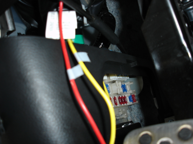

I did not want to splice into my electrical system so wrapped a small amount of the power around my 15 amp electrical fuse. The fuse is in-line with my cigarette lighter. This allows the unit to turn off with the ignition. Ground the ground wire to the bolt/ screw that is used for your hood release.

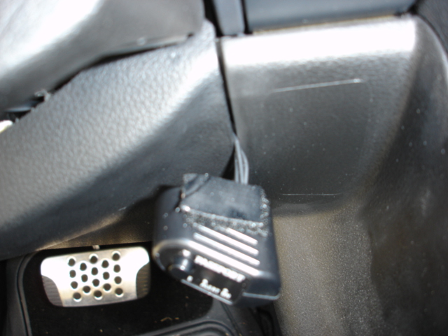

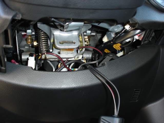

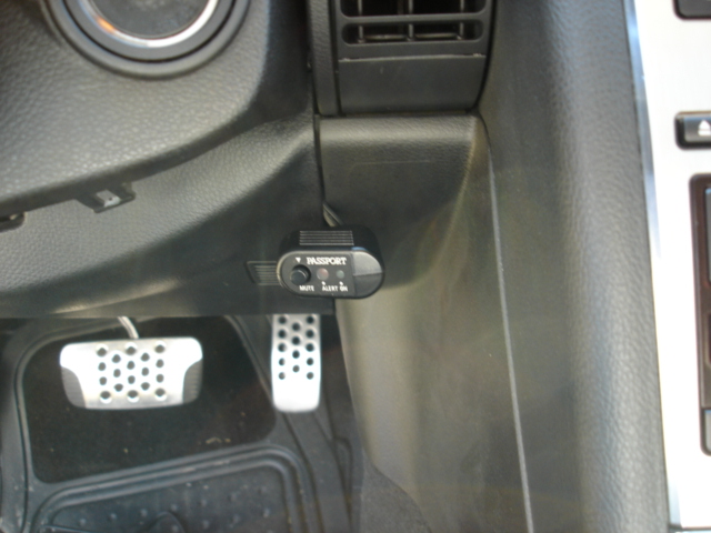

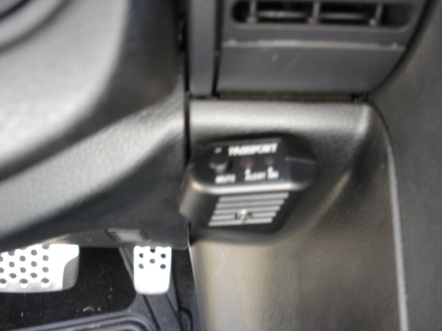

Step 3. I had a hardwired radar before so I tapped into the existing wire. Thats why you see the yellow and red wire. I ran the wire under the steering column so I can wire my mute switch. If you don't have a mute switch skip to step 4. Pull panel off under steering column and remove phillips head screw on the right side of the panel. Route wires under column. Then mount mute switch with Velcro.

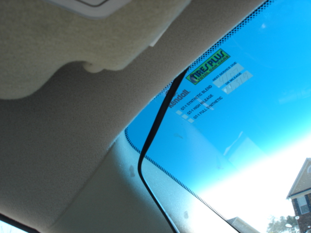

Step 4. Find a place on windshield you want the radar detector to be mounted to and start tucking the power wire for the radar detector their.
Tuck wire from radar detector to fuse panel.
Step 5. Bundle access wire with wire ties under dash. Put it all back together.
This is a very basic install and you can do this with basically any radar detector.
See pics below.

I forgot heres the fuse that you can grab power from.
