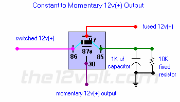

that is what I was thinking, but then how do you limit the power to only go to the acctuator for a certain amount of time as to not burn out the motor after it is fully extended.
(im not sure if that is explained correct. so say that I wired this accuator/relay combo to the ignition. once it is all the way open what can I do so that once it is all the way open that the power will cut out so that it will not ruin the motor)

12v dc question-constant-momentary.bmp I was thinking maybe I need to something like this

Most actuators have built in limit switches that will cut power from the motor when the actuator is fully extended. Otherwise, you will need a time delay relay for both the on and off action.
Or, of course, you could use smart electronics to do the job.

Something like a programmable microcontroller or a 'brain' of some sort. I think Dakota Digital sells linear actuator controllers.
