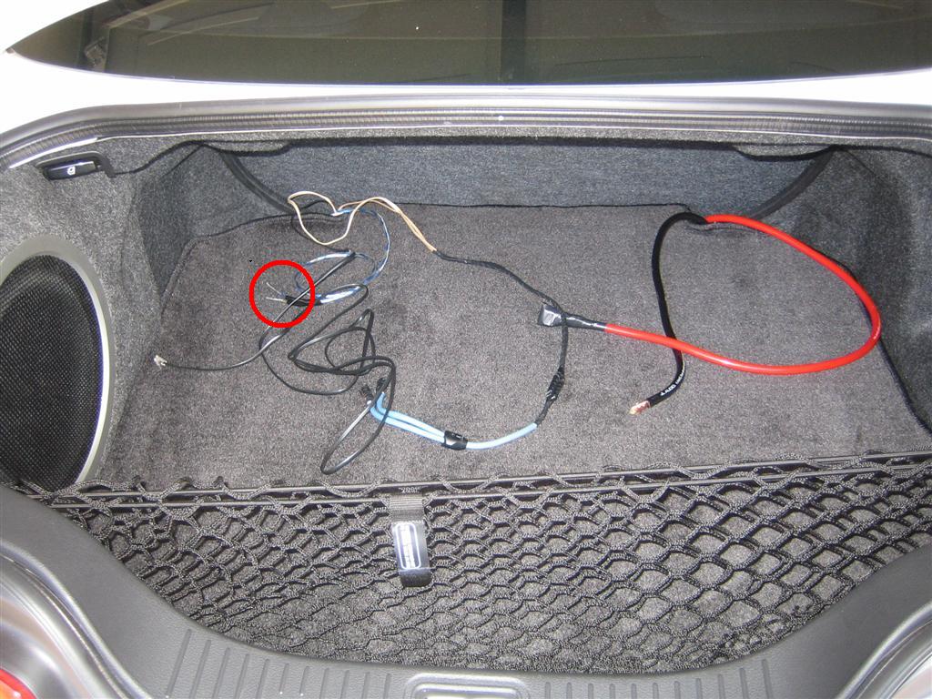

few questions regarding installation before i start doing it
1.what wires do i need to splice in order to connect them to the amp
Head Output Rear Right + Blue
Head Output Rear Right - Pink
Head Output Rear Left + Teal
Head Output Rear Left - Purple
are these the only wires or there are more that i need to splice?
2.do i have to disconnect the rear 6x9 speakers? if so, how do i reach those speakers?
3.i also have JL Audio XA-PCS4-1 4 gauge cable, do i need to buy anything else to hook my sub and amp up?
4.how do everyone run their red power cable under the carpet? what do u need to remove?
5.what is this wire, and where do i connect this to?(in the pic)
thanks

Here you go...
**You need one more wire from the blue harness. It's blue/silver and for the remote turn-on for your amp.**
**You need have to, but some have. I left mine connected. There's a post on how to remove the rear shelf speakers.**
**That will be more than adequate for constant +12V to your amp. Don't forget your ground, remote turn-on, and high quality speaker wires.**
**It's easy once you get thru the firewall. Simply unclip the door sill panel and tuck the wire underneath the carpet.**
**It's a line converter that you can get at any car audio shop. The best way to tap into the blue harness is to strip a 1/4" on the insulation, poke through the strands, insert and wrap converter wire, and then solder. You can use splice connectors, but I don't trust them in the long run.**

What do you need the line converter for?
