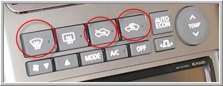

Sup Forum,
First time posting and want to piggy back on this thread. I also have a 2004 G35 and recently had a Pioneer AVIC-D3 unit installed by a local audio shop. The shop only carried the Metra DD Kit, so although I wasn’t too happy about having my OEM AC controls buttons replaced with those “soft-touch” Metra buttons…I went ahead with the install. The install came out better than expected, however I’m now seeing an issue with the Metra buttons. All the controls work correctly, however the lights of the top 3 buttons (view attached) will simultaneously “flicker” periodically.
I’ve witnessed the flickering more when the AC unit is turned on, but they also flicker when the AC is off. Now the flicker is very quick (maybe about a second) and it’s not a constant thing, however this small nuisance is driving me crazy! I took my G3 back to the audio shop so they could see it as well. The shop tech advised they will look at it with no problems, however I’m now concerned if this is just a “wire mishap”, defective controls, or a known issue with these Metra kits.
Has any other members with the G35 Metra DD kit witnessed this?
How should I handle this with the Audio Shop? They've already come back with some BS about "it’s an aftermarket kit so it’s not going to be perfect"
TIA,
- Jay

Metra is a well known company. Insist that the shop replace it with another one or give it back to them.
I guess there is a difference between the Metra kit and OEM, other than the buttons.

Yea... Metra is a good brand so I am sure this is not an example of... 'hey, its aftermarket'. I would request another kit from the shop. If they refuse, then I would ask them to give you a refund on the kit and you should purchase a JDM dd kit.

Thanks for the quick replies and feedback. I wanted a JDM kit, but the shop only carries the Metra kit and was advised they won't install items not purchased in the shop itself. The audio shop is reputable and good on customer service, so I'm sure I won't have an issue getting the kit replaced. I was just wondering if I should be concerned about a possible bug in the kit that causes the flicking issue. I haven't seen any other postings on the matter, so I probably have nothing to fear. I'll keep you updated on the results.

Most good shops should install OEM parts for their customers. Since your shop doesn't, they should definitely replace that defective Metra unit, especially since they installed it.
