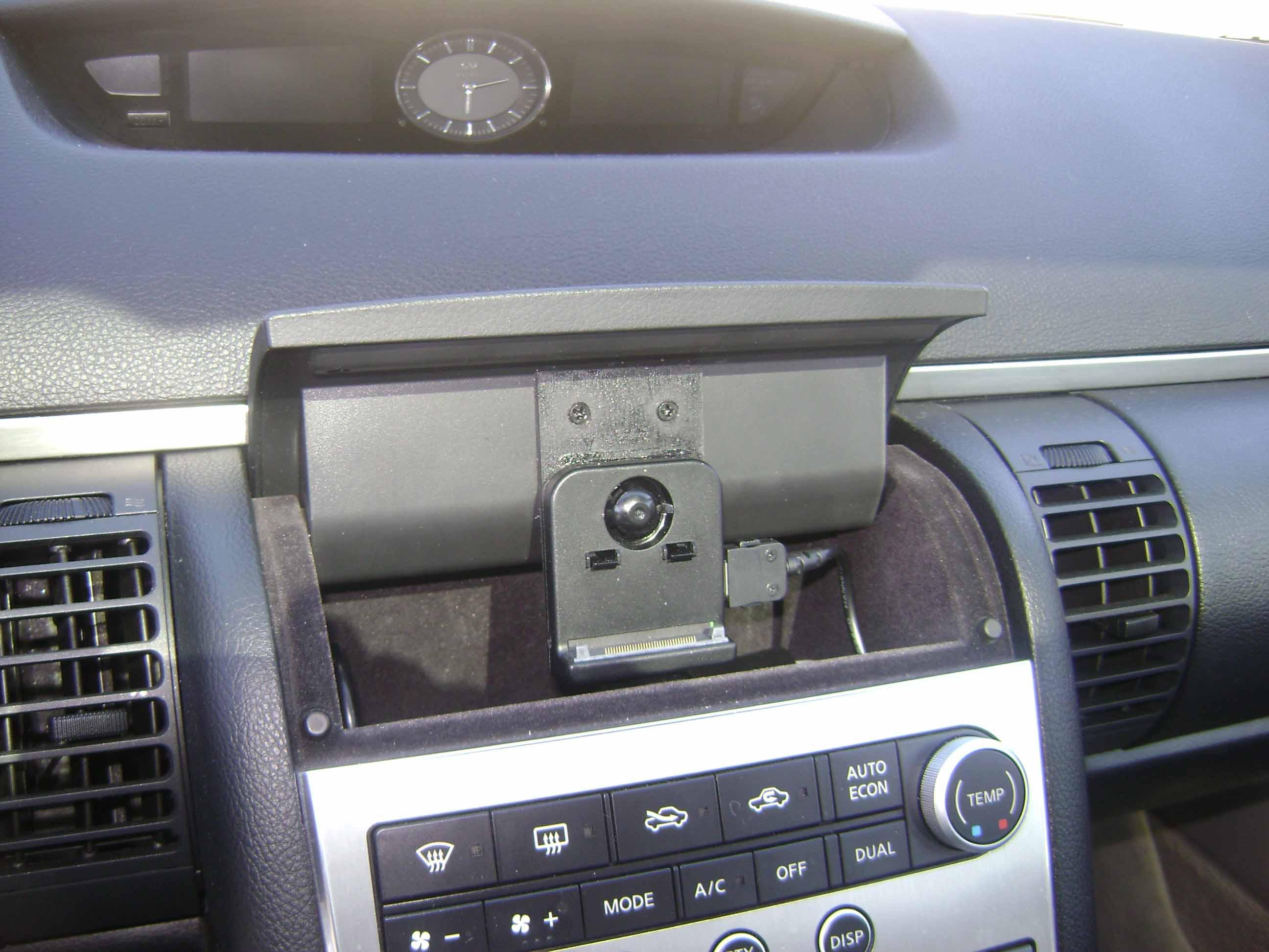

Originally Posted by luckyG35
Nice setup. How did you attach the homemade bracket to the cradle?
Thanks for the info and pictures.
I attached the cradle to the wooden bracket using plain old epoxy. I took the cradle apart, and found that it is possible to use small screws, but I determined at that point that the cradle was going to be a permanent fixture in the G35 and used glue. I know its lame, but it was easier to buy another cradle and power cable for the install in my trailblazer SS than to make this one removable.

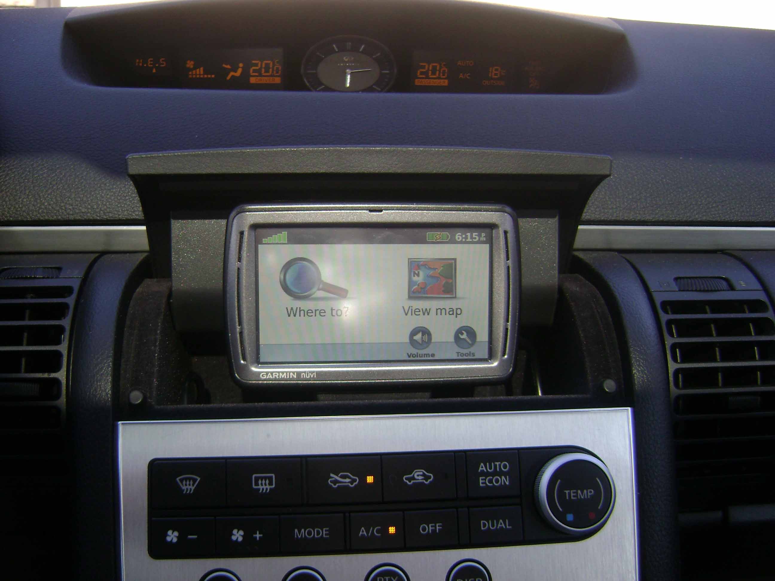

[QUOTE=swest1970;3156743]
Originally Posted by swest1970
I just did the cubby-hole GPS install using a Garmin 850, on a '05 6MT sedan.
I have some pics of the Garmin 850 install - using the Garmin 850 cradle and side-mount power plug...
Attachment 91966
Lid is manually opened/closed, lid will close fully.
Attachment 91967
This is the Garmin cradle for the 850 model. It ONLY fits the 800 series, and has the power cable attachment on the lower right corner...
Attachment 91968
In operation - note the full signal strength...
My previous post is is in regard to ^^^^ or anything similar.

I have a Nuvi 205W in my cubby and it closes perfectly. The door does not move at all when I am driving.
