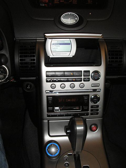

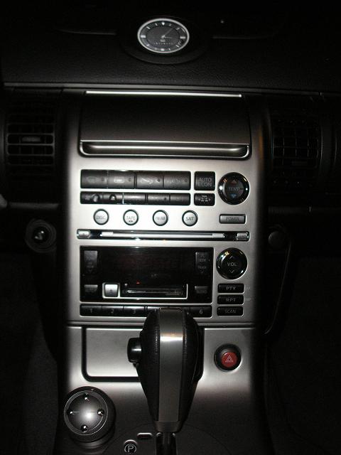

This is the setup I have been running for a while now and have been very pleased with the ease of use. I still use the stock HU and everything else so the sound is not improved.

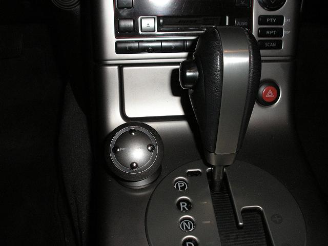

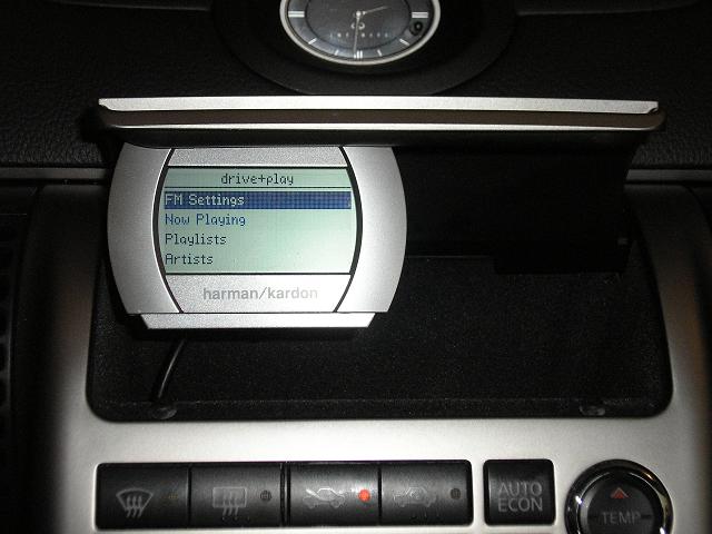

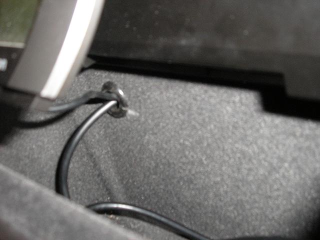

I use a Harman Kardon Drive + Play to control the iPod. The screen is mounted in the little cubby which still closes. The control **** is mounted by the shifter and required a hole to be drilled. The wires for the screen and iPod connector are run out the back of the cubby, behind the stereo and to the area below the center console where all the control boxes and wiring are hidden.
I used the Pacific Audio Corporation AAI-NIS2 to get the sound from the HK D+P to the stereo by overiding the SAT which I didn't have anyway. This also has a remote out that allowed me to have the HK D+P only turn on when the stereo is selected as SAT.
The installation went fairly smooth but I would suggest to anyone who wants to do something similar that this will take more time than you think. There are great posts on this forum that provide detailed instructions on how to remove the stereo which needs to be done to get something like this working.
