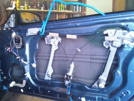

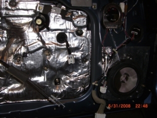

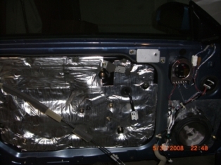

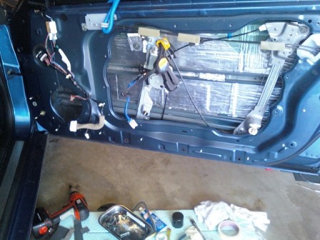

This soud deadening project is as time consuming as everyone says it is but the results certainly are great. First you can see the "B-Qiet" sound deadening material followed by sound deadening foam. Spray adhesive was used for the foam.

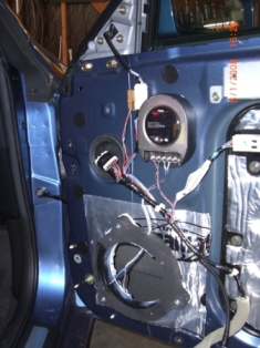

The MDF spacers are sealed with paint and silicone just incase they ever do get introduced to water. I removed the bose speaker and put in a 5 channel pdx amp mounted in the factory location. The head unit is an Alpine IVA W200 with Nave and bluetooth.
I'm very happy with how this door project turned out. the tweeters were a pain though and I had to do some buchering with a dremel to make the fit.
Now that I have the amp hooked up the other factory speakers have improved 200%. The factory amp is the weak link for sure.
