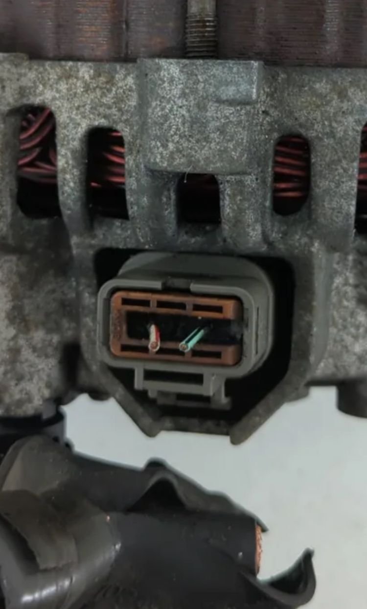

I have an aftermarket deutch connector but the factory 3 wires fell out cant find it in the manuals.
Thos fits the alternator but the colors dont match please help.

my buddy got a little to eager with the pry bar and destroyed the gray plug it left the pins behind i was going to just repin the replacement plug but they look a little different i just need to know what wire correlates with what. Assuming black would go to the ground and one must be ignition havent had to wire many alternators

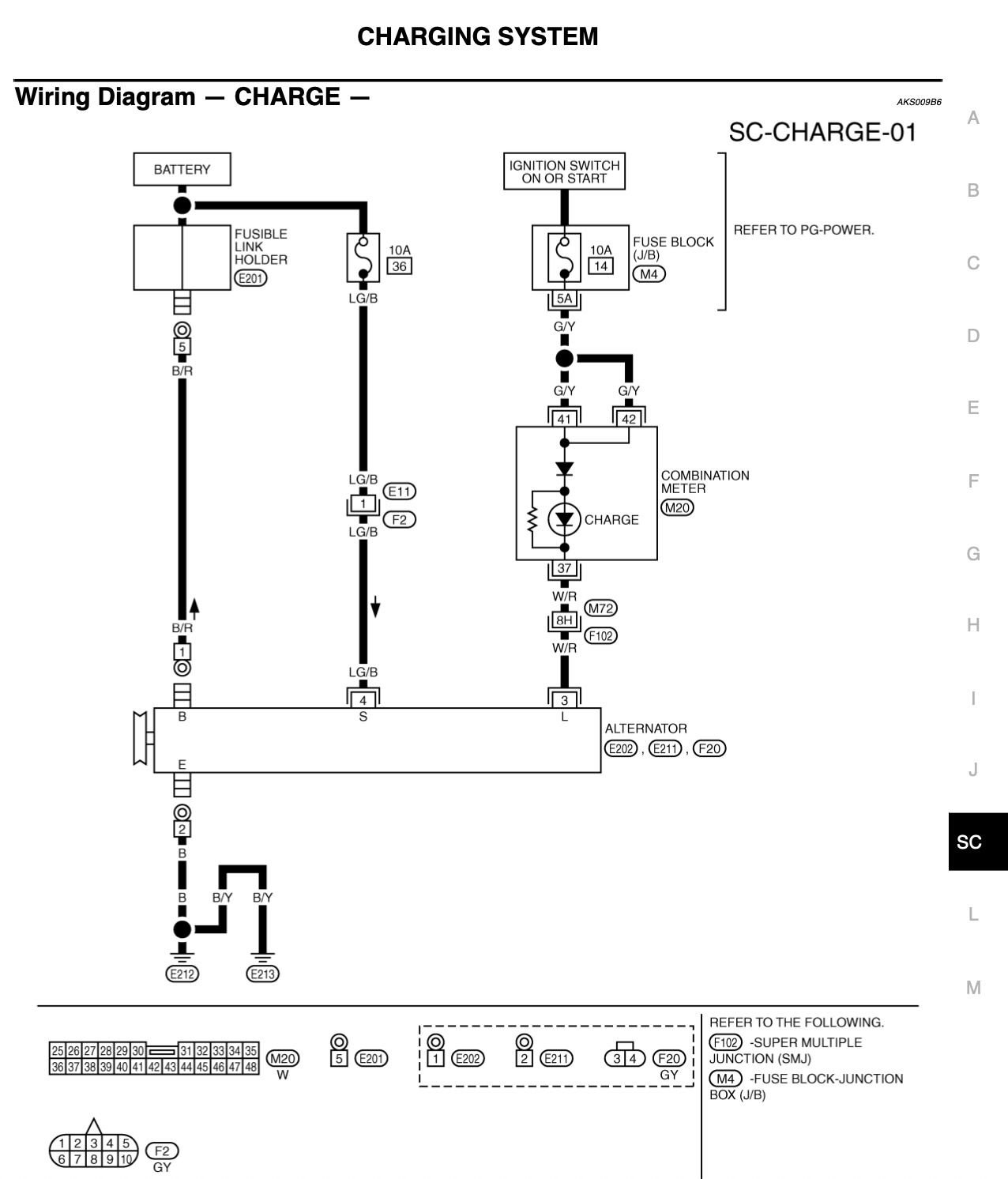

I believe your original alternator only had those two wires in that plug - Light-Green w/Blue stripe on pin-4 and White w/Red stripe on pin-3. The main ground and power connections were individual wires connecting to their own posts - Black for ground and Black w/Red stripe running to the battery (fusible link). Hope that helps.

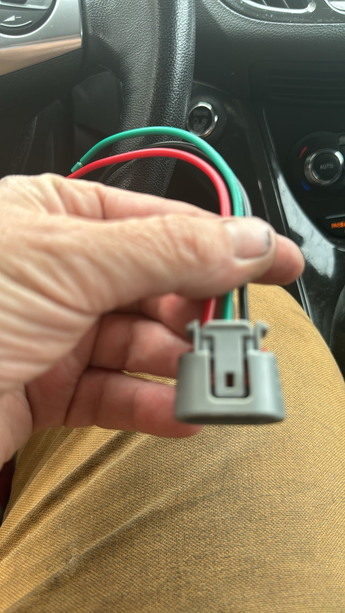

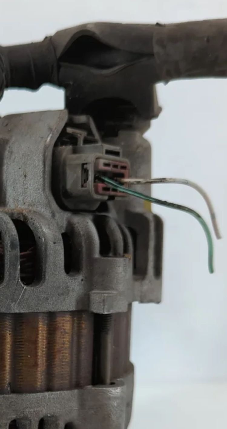

Did you get it fixed? I have a similar issue. I went a little wild with the snips and cut mine at pretty much the same spot as your plug. And yes it’s a 2 wire plug. I ordered a new one but I’m having trouble getting to the other end of the wires I cut to connect this new plug. Just wondering if you had any tips to make it easier. I contemplated trying to find where the wires go to so I can just splice a new wire in from the top of the motor but I’m not sure where these go and if the colors change anywhere along the way.
