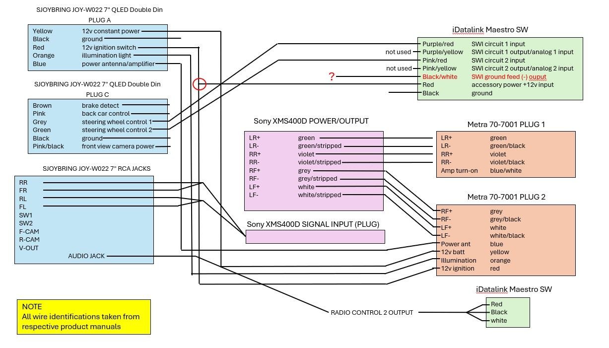

My son purchased a 2005 G35 coupe last year, and for as his birthday gift I plan on installing a new stereo for him, but I'm having trouble figuring out the wiring, specifically where I need to attach the Maestro black/white wire.
The instructions provided by Maestro instructs me to connect to A11, a yellow wire, but since I'm using Metra adaptors
I'm not sure this applies.
I've attached a rough schematic of the wiring. Any help pointing out mistakes is be fantastic.
Thanks in advance,
James
I've purchased the following for the install
SJOYBRING JOY-W022 7" QLED Double Din
Infinity Reference REF607FSL (x4)
Sony XMS400D amp
iDatalink Maestro SW
Metra Electronics 95-7605 Turbo2 Double-DIN Dash Kit
Metra 70-7001
American International NSB710 Speaker Mounting Brackets
