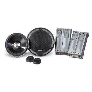

The large tweeters on the
BA Pro60se BA Pro60se
's fit in the stock location, you just have to use some high-temp hot melt glue and/or make brackets to fit over them.
The sound from these components are fantastic too! More bass than the Bose subwoofer ever had just from the midrange drivers.
The crossovers are huge, but there's a couple places to mount them in the door:
