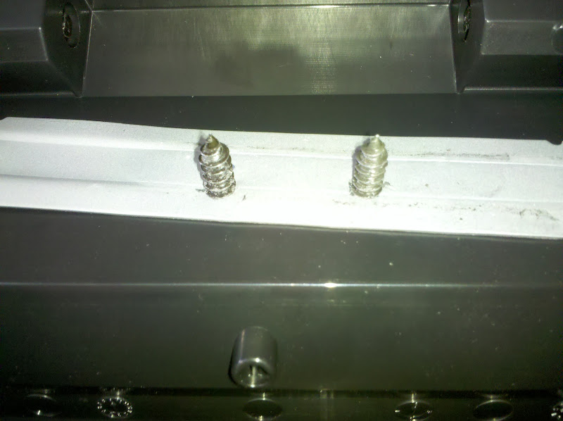

Thought I'd share my method of mounting my Droid in my non-nav 06 sedan.
I decided to mount my phone in the cubby hole above the radio/hvac controls. I already had the auxiliary input (PAC aPAC-NIS1) but the cord from it was just hanging out from the center console, so this would be a good opportunity to clean that up. I tapped into the cigarette lighter and added an additional cigarette lighter behind the radio. I plugged my phone charger into that and ran it and the aux input through a 1/2" hole I drilled in the back/bottom of the cubby. I attached only the phone holder section of the Motorola window mount to the lid of the cubby using some self-tapping screws with a steel backing plate to make sure it was solid.
I couldn't be happier with the way this turned out. The lid stays up by itself and it can be closed with the phone docked. It looks 100% stock when the lid is closed. The phone also goes into car mode when it's docked due to a strategically-placed magnet in the Motorola mount.
Attached are some pics of the install.
Attached Thumbnails Motorola Droid phone mount in non-nav cubby-g35-carmount-1.jpg   Motorola Droid phone mount in non-nav cubby-g35-carmount-3.jpg   Motorola Droid phone mount in non-nav cubby-g35-carmount-4.jpg

It's mounted with two screws through the cubby lid.
For some reason I'm not able to upload pics to the forum right now, but here's a link to the back side of the lid. You have to take off the lid cover trim piece (4 TINY screws) to access the back.
