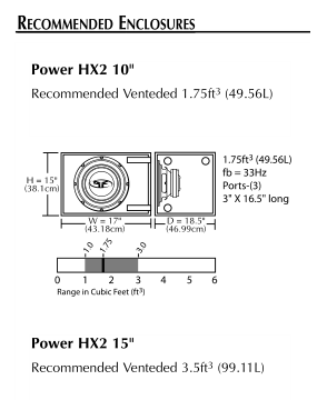

Which model hx2 is it? I know they're more spl oriented, so small sealed shouldn't be an option.

I need a model # so i can pull up the manual.

Rockford Fosgate Punch HX2 RFD2210 10" Dual Voice Coil Component Subwoofer
Old Apr 27, 2011 | 05:19 PM
eggyhustles's Avatar
Joined: Jul 2008
Posts: 829
Likes: 24
From: New York
