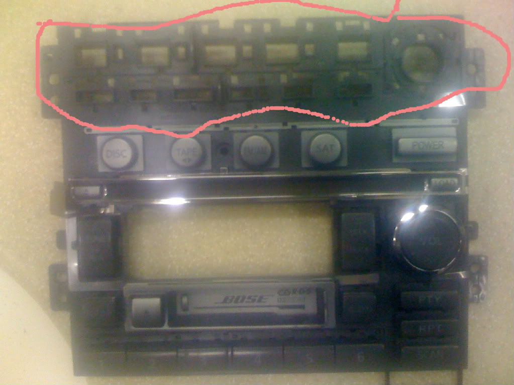

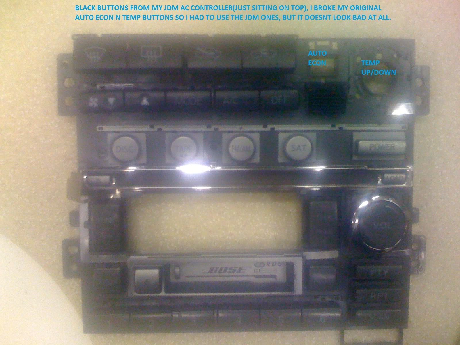

Nope, cant do just a board swap :/ your JDM board is just a section of your OEM one :/

Hmm, I am aware this is a separate unit, but to me it looks like you could just cut off that top A/C controller plastic piece with a dremel and reuse it with the new JDM A/C controller board. I have successfully removed all of the buttons off of the new stand alone board, but realized that the divider in between the buttons is black too, so that would have to be painted to match my grey buttons. Figure I can make this a whole lot easier and just cut the damn thing off the original. I'll have to see how well it goes when I finally decide to swap everything out.
Thanks for the photo though, its very helpful.
