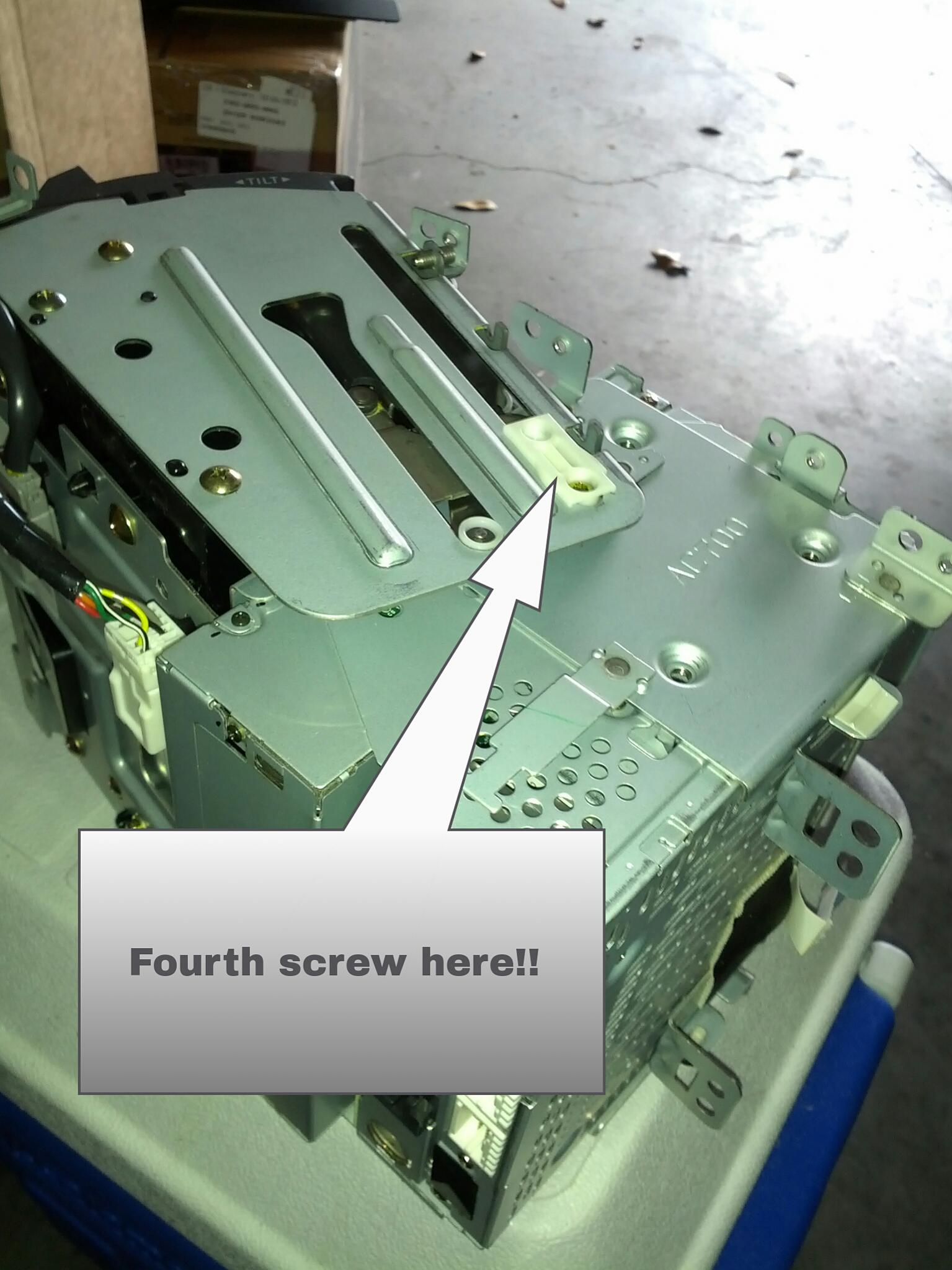

I've got together all my items for my install and I've gotten everything apart. What seems like the simplest part is giving me the most trouble.
I've got my OEM radio and navigation out of the car but can't seem to get at the fourth screw in the bracket that holds the radio in. It is obscured by the metal piece that guides the navigation up and down.
Can anyone tell me how to get at this screw? Thank you!!!

I don't remember having any trouble at all getting to any obscured screws doing my car with navigation.
Can you give a better picture, because I don't think there should be any problem with screw access.
Thanks Wrathernaut! Your guide has been the best and helped me tremendously. I finally figured this out, I just needed to disconnect the navigation unit from the bracket, once its off you can get to that fourth screw no problem.
