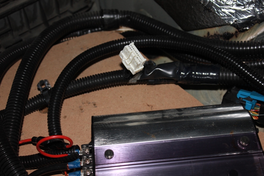

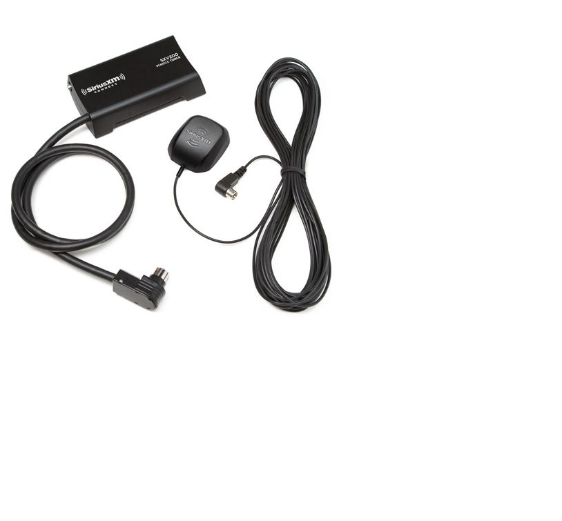

I purchased a SiriusXM SXV200 Vehicle Tuner as shown below in the attached picture. I searched and searched here and google trying to figure out how to connect the tuner to my "pre-wired" factory radio. I could not find an image of the "small white connector" referenced in a few other threads so I am attaching a picture of what I think is the correct connector.
First, is this the correct connector? If not can someone post up a picture of the correct one?
Second, how do I connect the round "SMB" connector from the SXV200 tuner to the rectangular pre-wired "small white connector"? Obviously I need an adapter or another piece in between. Can someone point me in the right direction?

The SXV200 is not designed to work with the factory radio in any way. It's designed for compatible aftermarket radios.
If you're trying to get something working with the factory radio, you need a factory satellite radio tuner.
Return what you've purchased or buy a compatible aftermarket radio.
