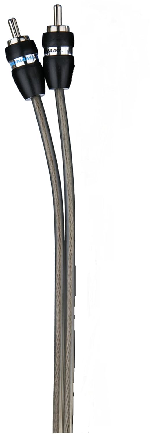

Originally Posted by DBayPlaya2k3
RCA's Cables (x2): DB Link EST17Z 17 Feet Elite Soft Touch RCA Cable
Amazon.com: DB Link EST17Z 17 Feet Elite Soft Touch RCA Cable: Car Electronics
These look like at least partially unshielded twisted pair to me (to show off the twist, of course!). If they're shielded except for the part by the end, probably not the source of noise though. I used double-shielded Tsunami brand RCAs on mine.
