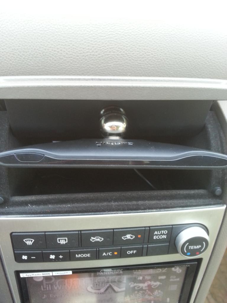

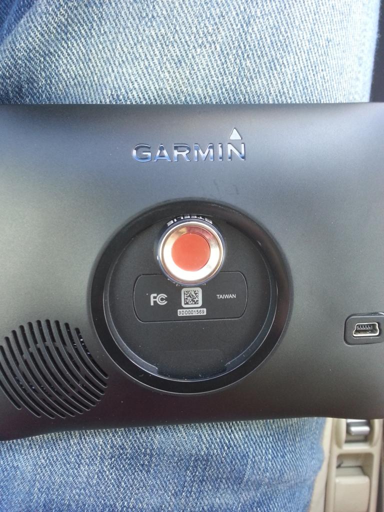

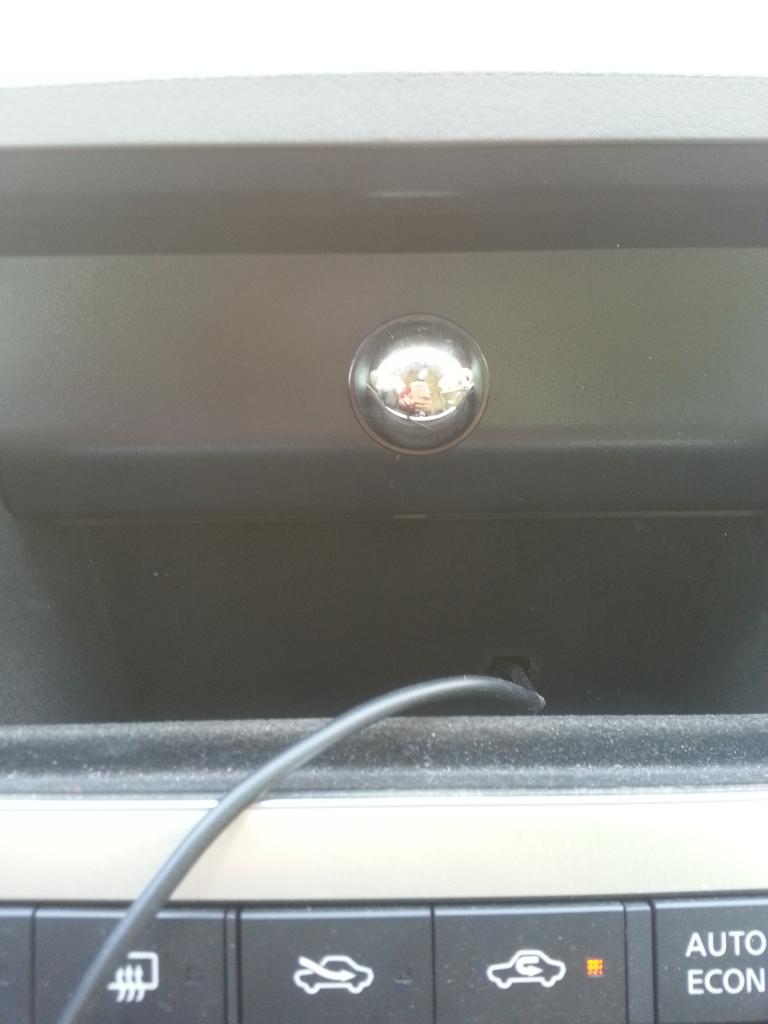

I mounted the Garmin with a Steelie Phone Car Mount. Its basically two magnets with 3M tape at the ends.

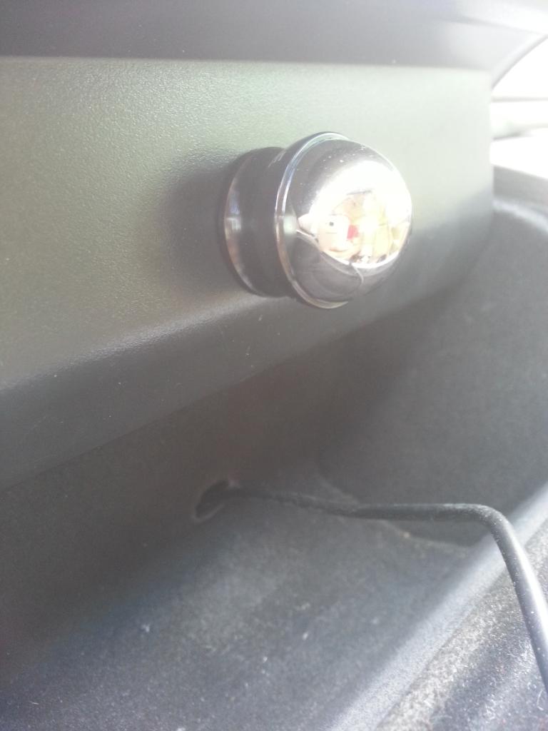

I mounted one part of the magnet on the back of the GPS and the other on the cubby, that way when I take sharp turns the Garmin stays in place.

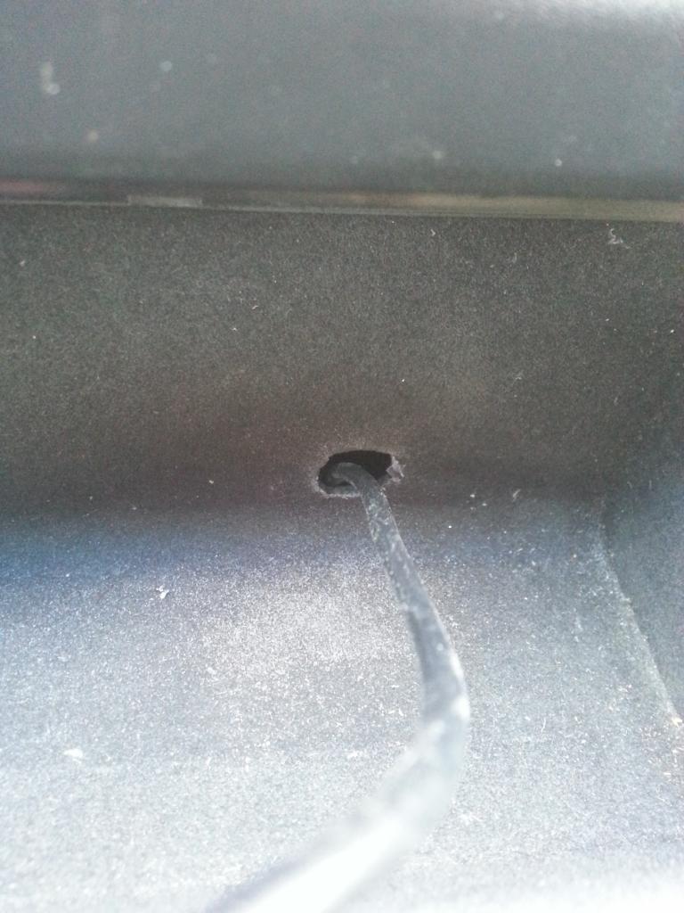

Then I drilled a hole in the bottom of the cubby to fit the Garmin cable and ran it all the way through the center console to the armrest.

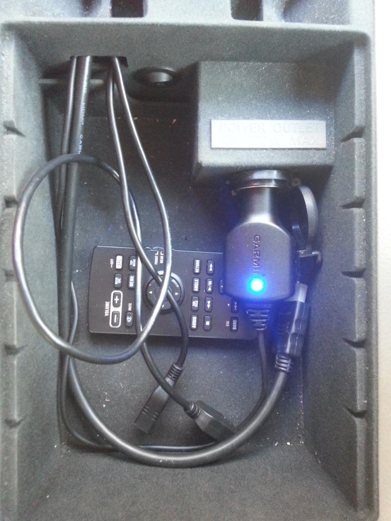

I cut out a part of the armrest compartment to fit all the wires through for my Pioneer double din and also the Garmin plug. Clean and simple
