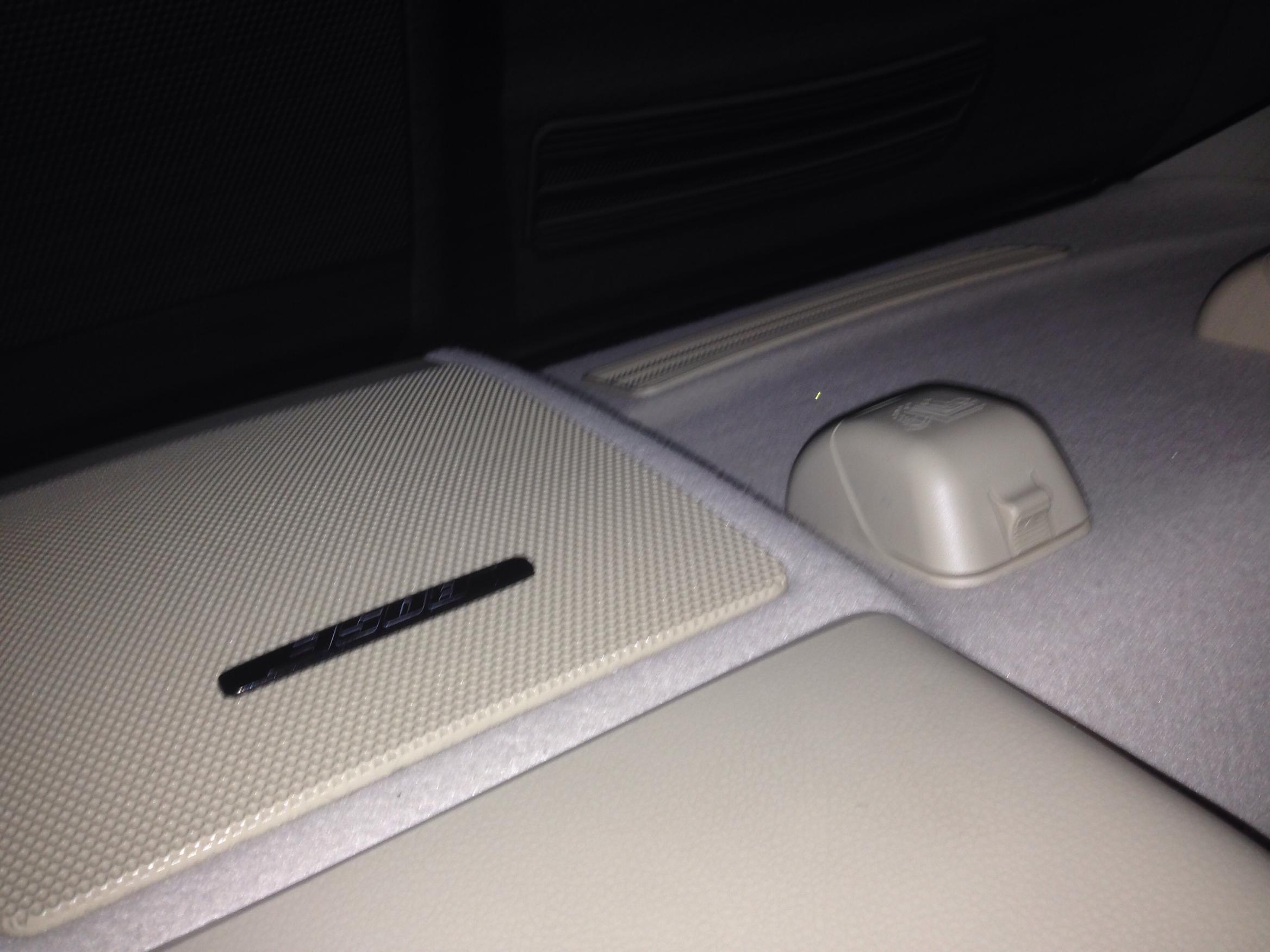

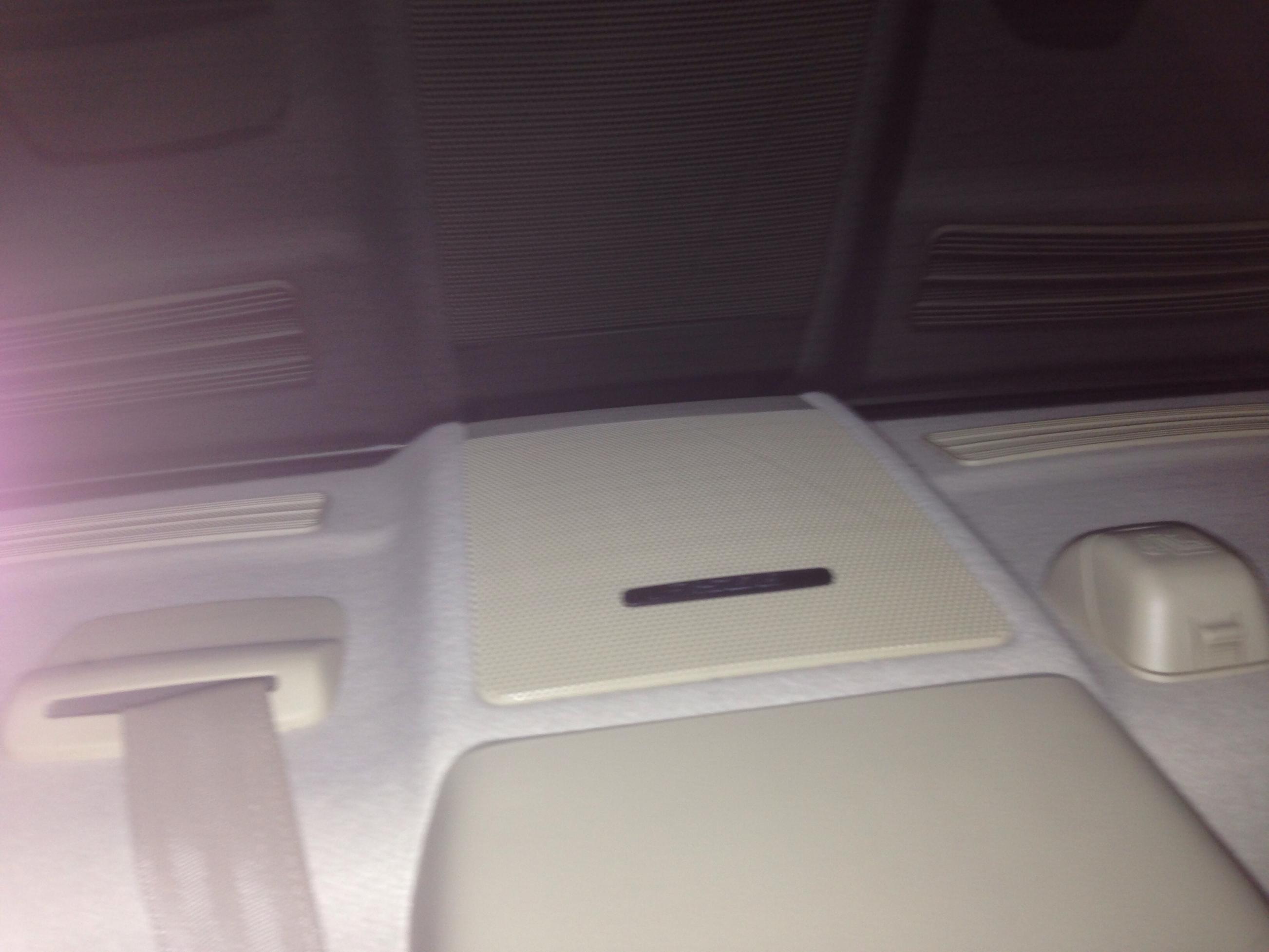

I am on a pretty tight budget and do not want to upgrade the speakers just yet, just add the amp. I noticed that the sedan has speakers on all the doors and a 8" sub on the rear deck, but right by the sub on the rear deck on both sides are some sort of vents/tweeters? I'm not sure if these are vents for the amps or if they are some sort of tweeters in conjunction with the rear door 6 1/2's. I know for a fact that they are not 6x9's because they are in a straight line, not oval shaped. I can upload a picture soon of them but right now I am writing this for feedback as I have to go to work soon. Would adding this head unit/amp combo help boost the system? Anyone know what those rear "vents" are? Also, if I did install this 5 channel amp and the "vents" are tweeters of some sort, could I run them off of the amp on a xover from the rear speakers? Or add them on a separate input from the head unit?

The vents are just air vents.
