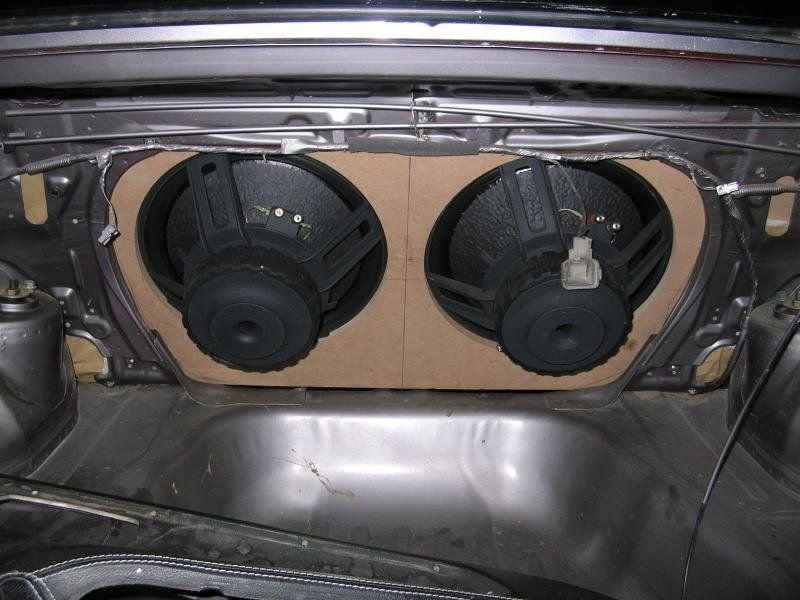

Anyway, as for the sub problem, if you really want to maximize trunk space and get the most out of your watts, reinforce the rear deck (heavily!) and run an infinite baffle setup from there, or do it behind the rear seat -
If you can get your hands on a 4080 box, you can keep a good amount of space as well, but you'll need more than 270 watts with a sealed box if you want to keep up with 300 watts of components. 500 can definitely do it. JL does make a stealthbox for the coupe, but that might be taking away more trunk space than you want.
