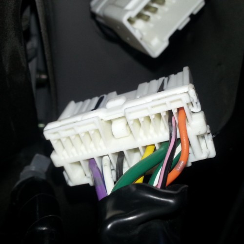

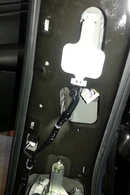

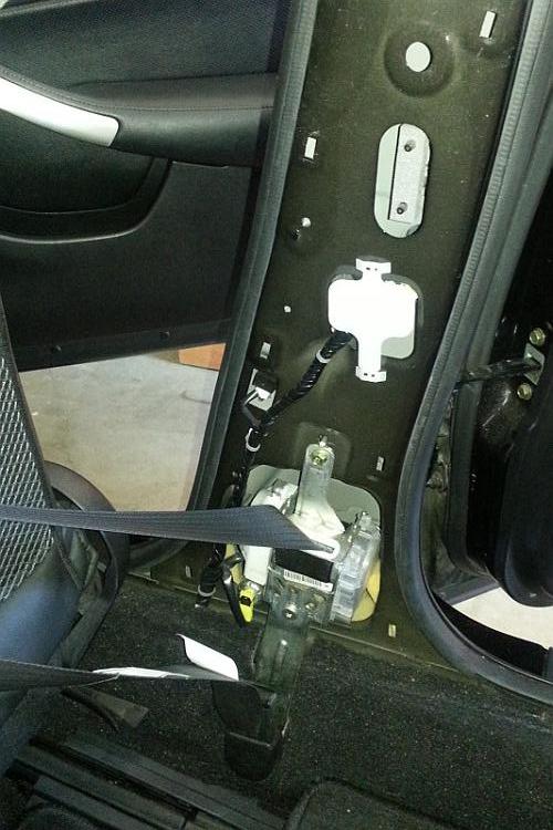

2) If all you're doing is adding a sub in a non-Bose sedan, there is a great tap location for speaker wires in the right B-pillar (thanks, Wrathernaut). See photos below. The two wires are adjacent to each other on the corner of the connector. Wire colors:
- Rear right (+) = Orange
- Rear right (-) = Black/pink
You need to flip up this white plastic cover to get access to the connector.
Connector close-up. It the two wires on the top right in the photo.
There is ample room to secure a LOC in the B-pillar. I drilled and tapped a hole there and mounted mine with a single machine screw.

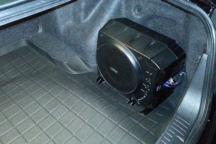

3) In a sedan, the recess on the right side of the trunk is perfect for the Basslink. It nests in there very nicely. I secured the sub by drilling and tapping 10-32 holes into the floor pan. Unfortunately I had to cut up my new WeatherTech trunk liner, but it came out looking pretty nice. I folded/rolled the edge of the carpeted mats and they tucked in nicely into the spare tire well.

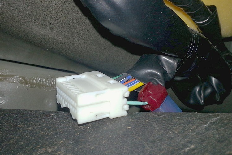

4) There is a convenient wire for Remote turn-on in the trunk. If you have a satellite trunk connector (as is standard on all 05-06 I believe), there is a Teal wire on the corner of the connector that you can tap into. Goes to 12V when key is in the ACC position, independent if the radio is on or not. For me, this was more convenient than running a wire up to the cigarette lighter. Yes, I got lazy and used a T-tap for this one. If you don't feel like soldering, I'd recommend using Posi-Taps instead of these, as they are more secure and don't damage the insulation as much.
