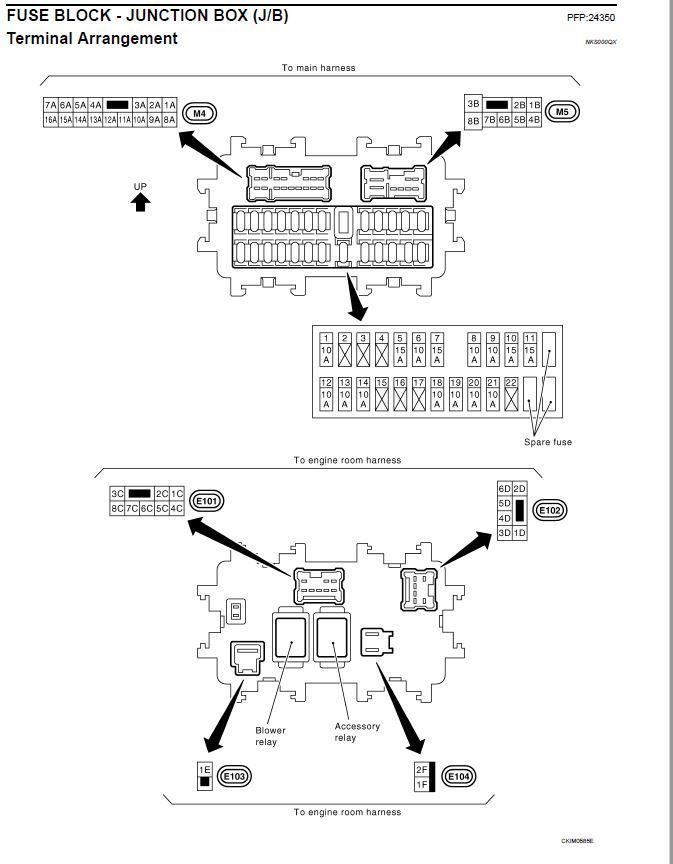

Did you check fuses in the IPDM, I think that's where it pulls power from.

Fuse 82 in the IPDM.

Or fuse 20 in Fuse Block - J/B

are those diagrams for a 2003 because my fuse 82 is my lo beam for right headlight and i cannot find the ipdm fuse

Nope those were from my 2006 because you didn't specify a year.
You can find yours in the FSMs which are online here.
https://nicoclub.com/archives/infini...e-manuals.html

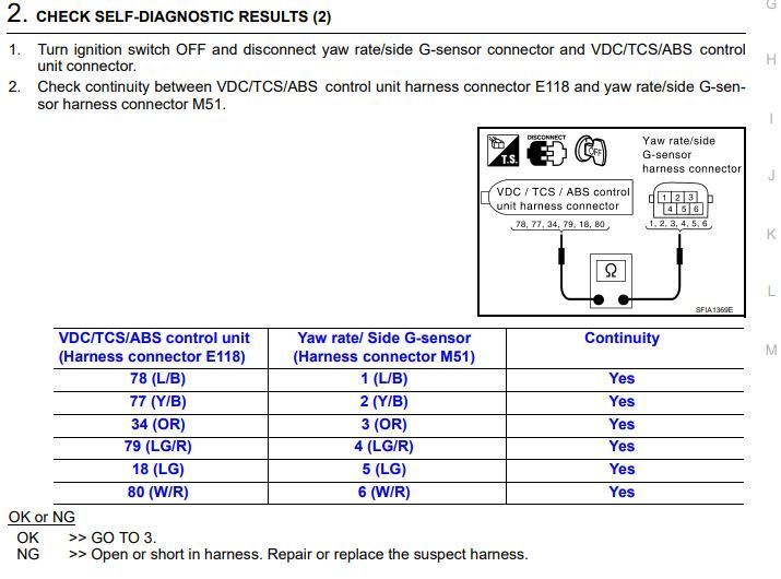

So all fuses are okay, and ive just been looking through the manual to try and figure out whats going on. It looks like the yaw sensor gets power from the vdc/tcs/abs control unit. Would there be a fuse between there and the sensor or should i test the terminal on the control unit that goes to the sensor? Im not sure what to do here id like to get it working rather than stealing power from another source.

Ok after checking that schematic I see those wires are all communications between the TCM and the yaw sensor, you shouldn't be reading battery voltage between those it's more likely just a scaling resistance change. What EXACTLY is the problem you're having now? The VDC light won't turn off or something? If you want to verify the wires are intact from point A to B then unplug the TCM and yaw harnesses and check for continuity between the 6 different wires, they're matched color for color on each end which is easy or you can reference this chart I suppose.
