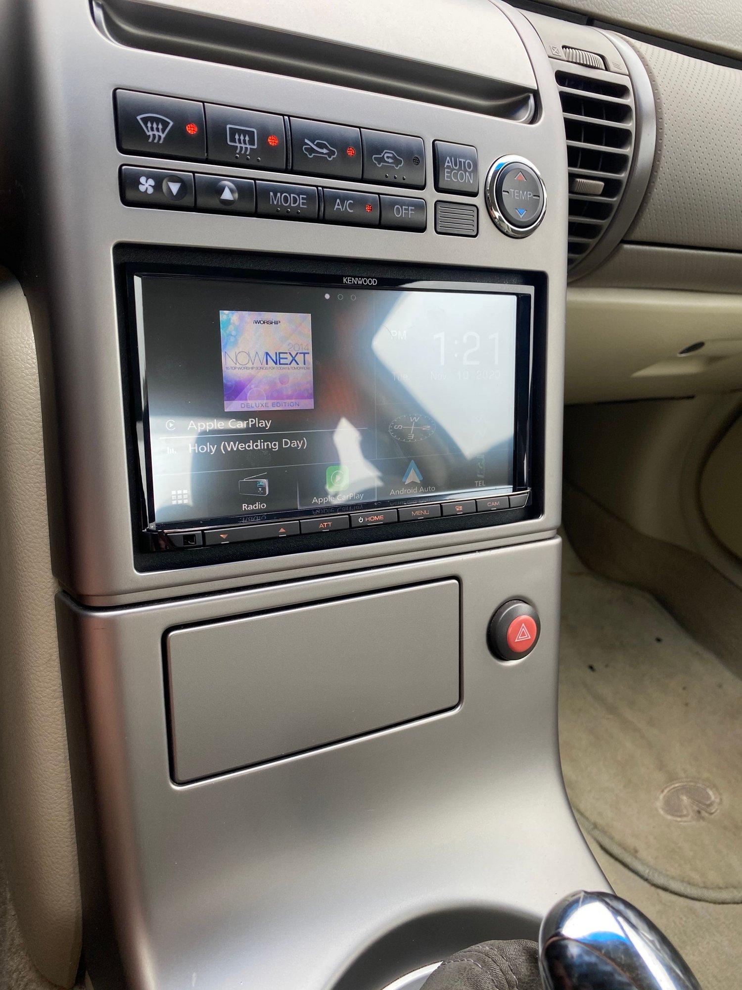

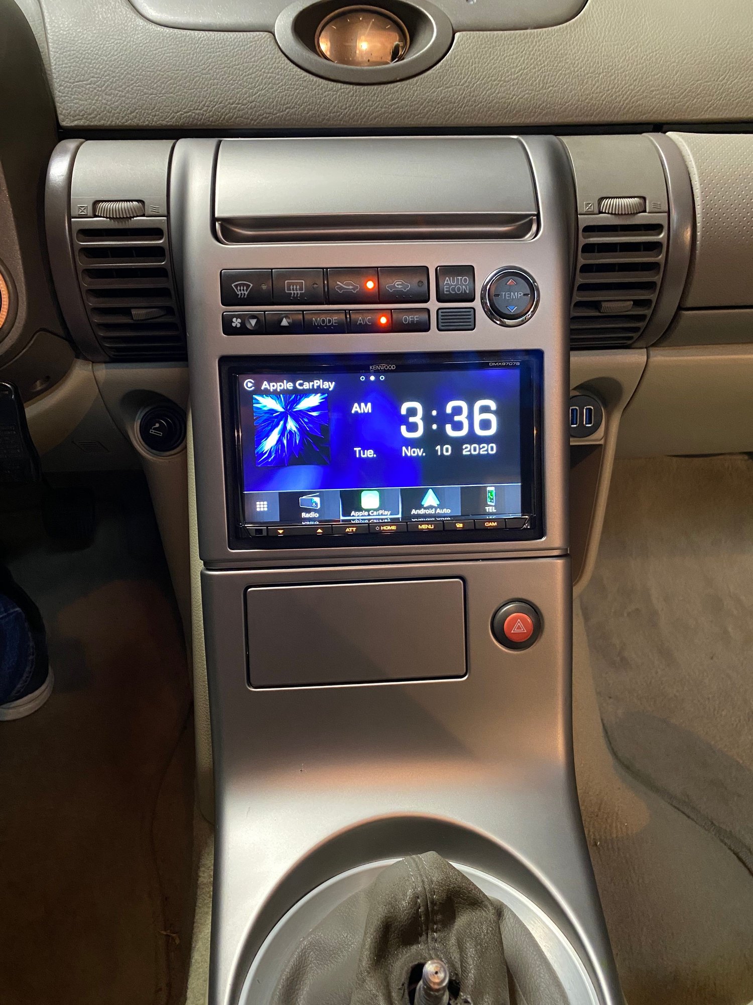

Update: Everything is installed and looking great! There is no way I could have done this without your thread Wrathernaut, I owe you one!

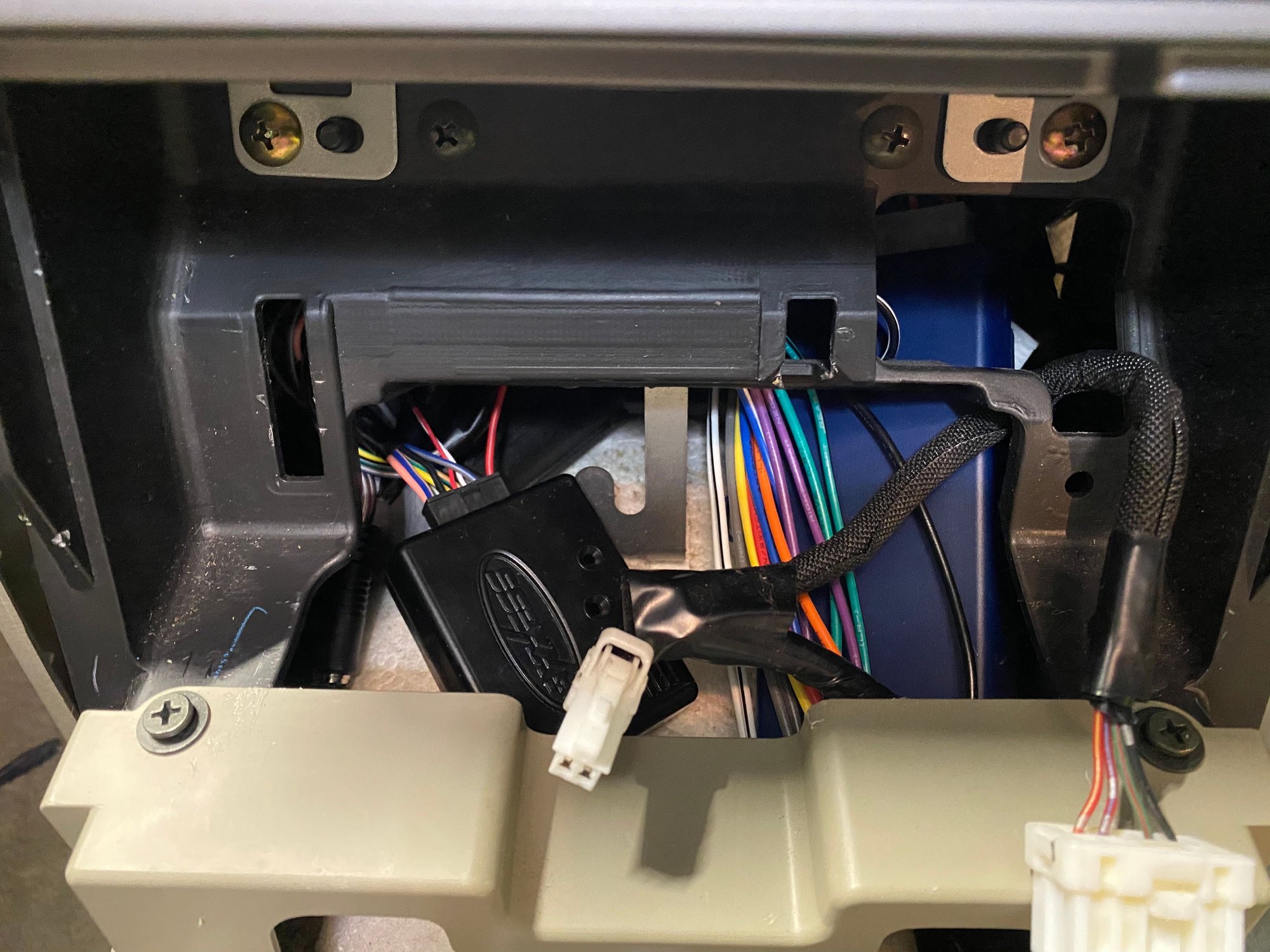

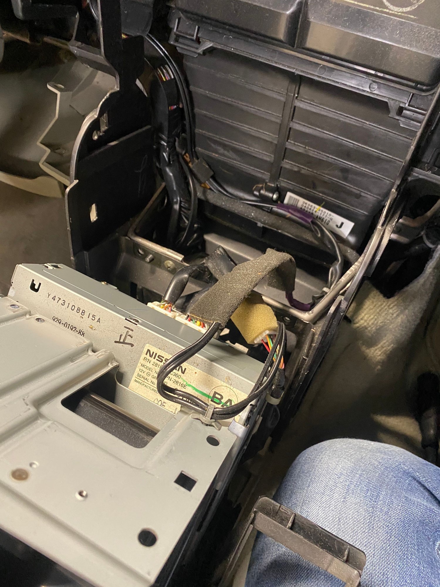

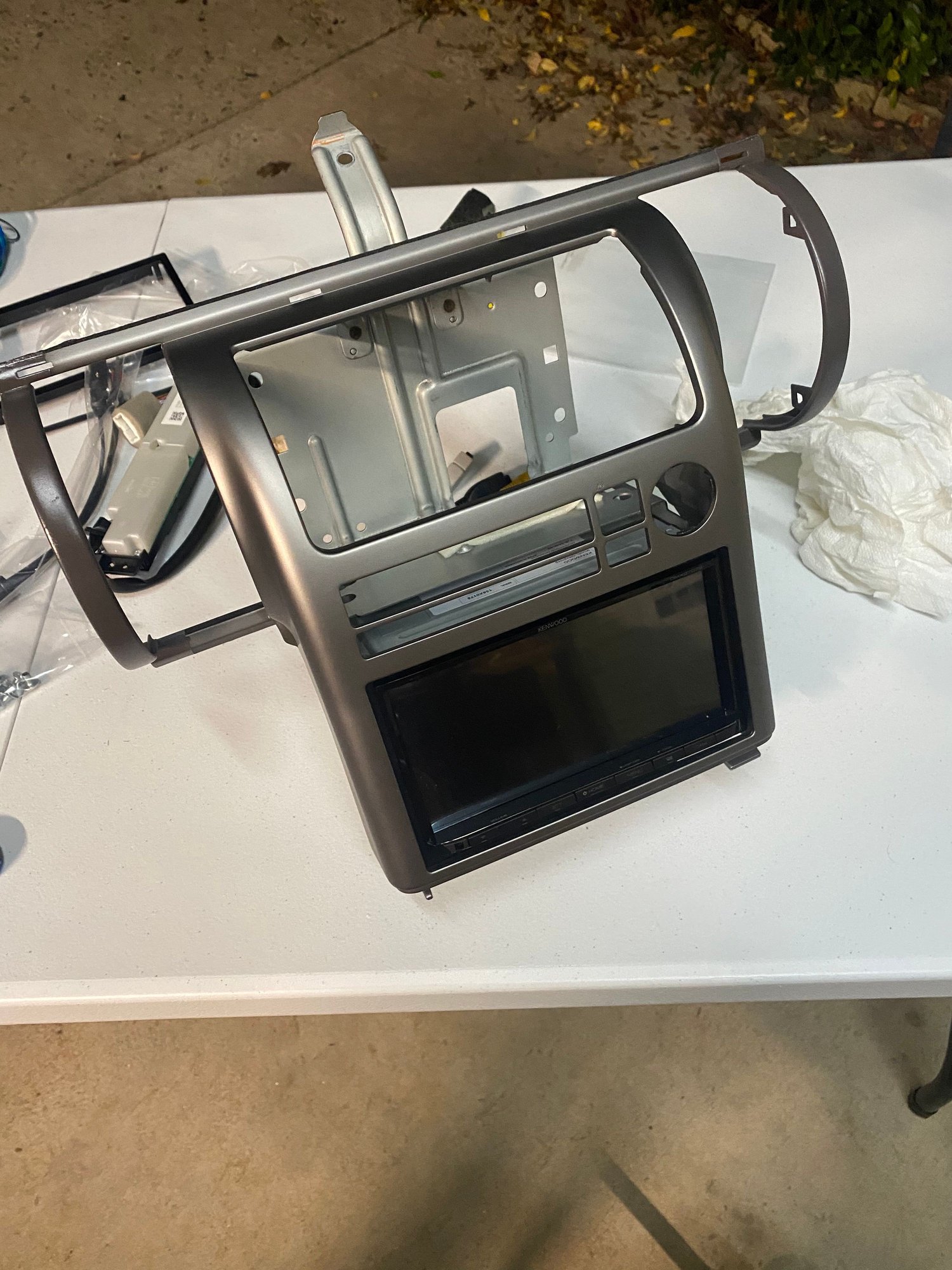

Just finished getting all the wiring connections done.
Taking the old stereo out.
Fitting the HU into the new JDM. I was lucky and didn't have to drill new holes.
JDM put into the car. Note all the various wires tucked underneath the HU.
Intentionally positioned the ASWC where I could have easy access by only having to take the trim off around the shifter ****.
Finally finished install at 3:36am in the morning, I started at about 7pm and took a few breaks. I did not want to rush anything.
So stoked to finally have this done!
