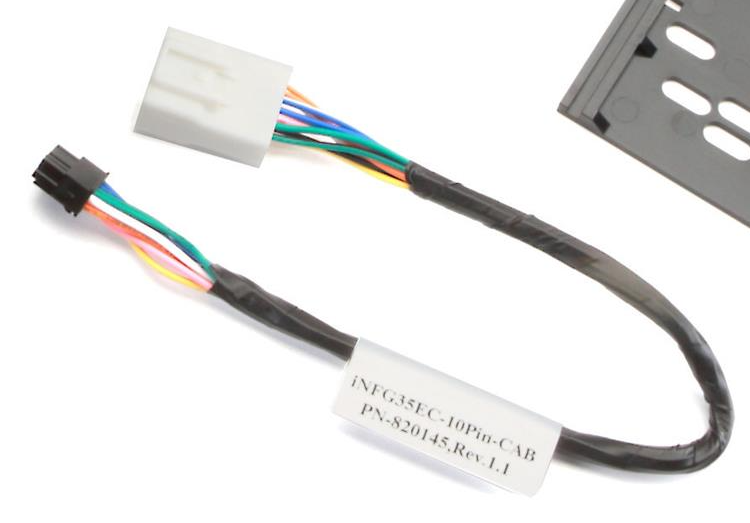

Hello, I recently purchased a metra dash kit for my car and I don't have a climate control cable for the kit to connect to the oem harness, are you be able to hardwire the oem harness from the stock radio to the new dash kit? Or is there any any way to get the metrA harness without a whole new kit? Please help someone, im lost and cant find any wiring diagrams or anything online.

You could cut the wire off the factory unit and connect it up. Here's the best image I can find that shows the wire configuration. The factory wires aren't going to be the same color, but if you follow the path, you can figure it out.
You can try searching for part# PN-820145 from metra, since they did conveniently label the little cable.
PN-820145
Here's a second angle:
One more for good measure:
