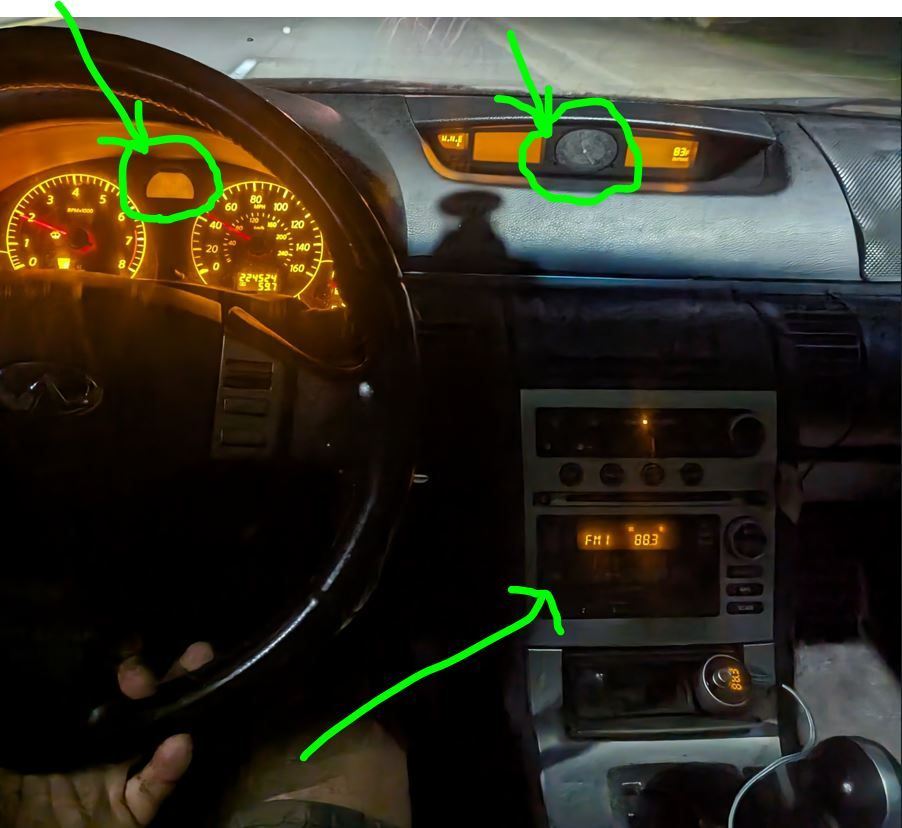

Long story short, I performed a rush job at a DIY garage in order to install a new valve body and TCM into my g35, I never unplugged the battery and I think it has caused a lot of my electrical issues. Immediately after rushed install (in attempt to save money) I noticed my drive display was gone along with my speedometer and gas gauge sticking and reading improperly also ses and at check light. Wasn't until later one of my tech friends stated I needed the TCM programmed for the car, even though I've been driving it a couple years in manual (which i wouldn't say was the best idea). As of recently my stereo lights and shortly after tail lights went out both of them but the signal and brake lights work. I changed the fuse in the taillight and no difference. There was even a moment my dash lights went out and my car began making a high squealing noise when I was parking at my apartment. I keep the car well maintained work on it myself and give routine oil changes every 3-5k mi. This Situation however has me kind of stumped I'm not really a electronics person and things are beginning to snowball and stress me out. Now I'm limited to driving hours I can only drive at day to avoid getting pulled over.
Lights on stereo out, Drive Display out and clock like out (Clock and stereo lights were working last week)

What year? Looks like a 2005-2007?
The TCM only needs to be programmed if it was NEW, a used TCM doesn't require programming.
I think the gear indicator, clock, and new problems are all separate issues compared to the other stuff going wrong. And the clock would be it's own separate problem, you need to start checking fuses, cabin Fuse Block - J/B fuses 6, 9, and 12 all handle the AC auto amp which supplies power to the clock.
Have you had the dash apart? It's easy to screw up plugging things back in.
Do you have an aftermarket alarm, remote start, or ANY other aftermarket stuff running? Unplug that FM transmitter too, sometimes other aftermarket stuff fails and causes the OEM equipment to malfunction.
What codes are you throwing? I see the check engine light is on.
The high pitch squealing sound is probably just an accessory belt slipping.
As far as the brake lights, that's a completely separate standalone circuit with nothing else on it. Power comes from cabin Fuse Block - J/B fuse 20. If that fuse is blowing then you have a broken wire grounding out against the chassis somewhere. Primary culprit is the trunk area.
Do you have all the factory stuff in the trunk or do you have an aftermarket amp / woofers / etc? Is the carpet and plastic divider for the spare tires still in place? If that stuff has been tampered with it's easy to nick a wire and short it out.
