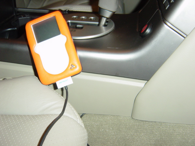

el_duderinio is in Portland, OR, otherwise known as Mambo Fvckland (inside joke for Speedaholic). His shop is avincar.com. You can e-mail him directly at avincar@comcast.net. He could get you what you need and he's not short on advice. Obviously they tapped into some power but the rest is just RCA plugs into the AAI-NIS and the docking connector on the other end into the iPod.
sd_diver: I believe it is a 4volt preamp out but is probably about 2-3 increments quieter than the other HU output. Not really a problem. I just turn it up without worry since he also tested clipping at high volume on the stock HU and found it to be basically non-existent at close to max volume.
See pic. I just let mine hang loose right now and keep the iPod in the cupholder, storage bin or that funky storage unit on the passenger side. I will probably eventually mount it but I'm happy right now. There was also another IceLink product that had a mount but it was black and didn't really match my interior but it did the same thing. Don't know model. el_duderino will.
