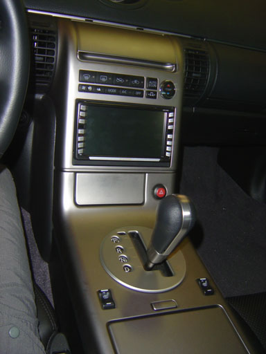

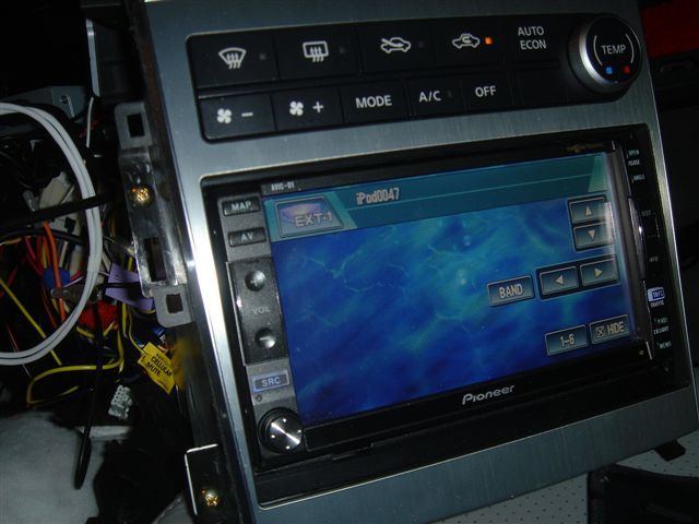

I checked the sticky, but it doesnt have any pics of installs or anyone that has done it on an '05. and I could only find the a/c controller for the 03/04
Old Oct 28, 2005 | 04:41 AM
RashMan1450's Avatar
Joined: Jul 2003
Posts: 2,937
From: Encino (L.A. 818), Killa Kali
Kia, Help This Guy Out
Old Oct 28, 2005 | 04:48 AM
GRider35c's Avatar
Joined: Apr 2004
Posts: 2,712
From: socalifornia
^u guys suck at the internet!^

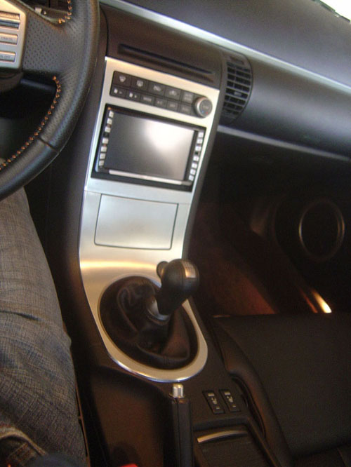

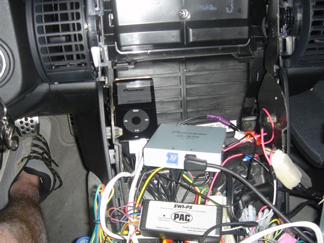

I did a Double Din Pioneer AVIC D1 in my 05 G35 Coupe. I installed the Ipod controller and the steering wheel control interface. I even threw in the aftermarket premium rearview mirror with homelink. I did a full writeup with pics. Do a search.
You can get the DD kit from Yosi at J's Garage. It costs about $400. You don't need a bracket. You need the new front panel, and a new AC controller. Tell Yosi what car you have, and he will get you the right stuff. It comes from Japan, took around a week.
Anyway, my steering wheel controls can control my Ipod (which sits in the glove).
Here are a couple fun pics for you...
