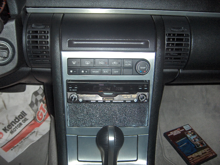

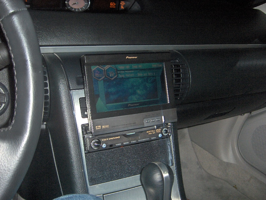

Originally Posted by senupi
I just purchased the DD kit to install a single din HU but I have 2 gripes about it. Secondly, I would need to purchase a lower pocket to fill the gap and I dont know where to find it. (i dont think its on grubbs anymore). Third, the HU would be in plain sight for theives.
Any store that carries and installs car stereo equipment will have a pocket for your dash. ie: BestBuy, Circuit City. It's about $16 at BB. If you get a HU with a removable face you wont have to wory about theives or you can just tint your windows.
-GP-
Here's mine, the whole below the HU is filled with a piece of ABS plastic and when i install my amp im going to put the bass boost and digital voltmeter in there.

^ Ya but accessing the temp controls is a pain in the ****....if you go DD, go with the AVN, not a single din in dash...
