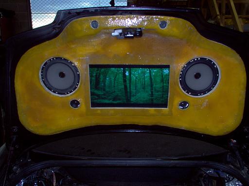

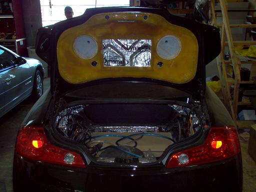

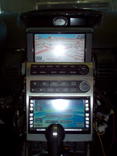

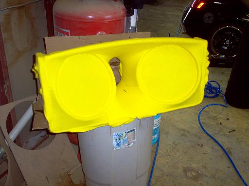

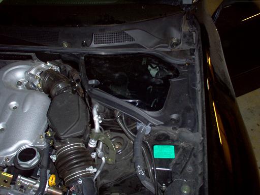

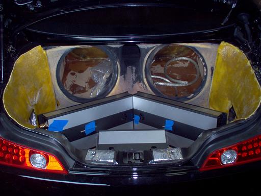

nm i called up some friends at infiniti and got it. that guide was nice though. Heres some pics like i said. Ive seen the double din in here but never with the factory nav to.

actually you need to run the low level output from the dvd into a amplified speaker. im using a clarion center channel for this install mounted under the dash. then i use a low voltage relay to activate a boshe relay to cut off the amp turnon to mute the system while the nav talks

I believe its the avn2594 from eclipse. we did that one because it is the only avn without nav. I believe that the total on his stereo was around 35K

Wow that much! Big baller! I ment the screen in the deck lid. Do you have anymore pics of the install?

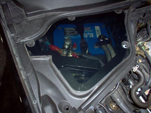

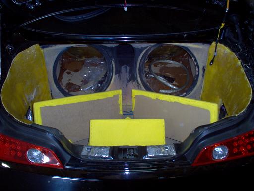

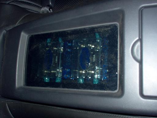

heres a few more pics of the build
Attached Thumbnails facotry navigation audio to aftermarket HU-box1-2.jpg   facotry navigation audio to aftermarket HU-g351-2.jpg   facotry navigation audio to aftermarket HU-console1-2.jpg   facotry navigation audio to aftermarket HU-trunklid2-2.jpg

and more
