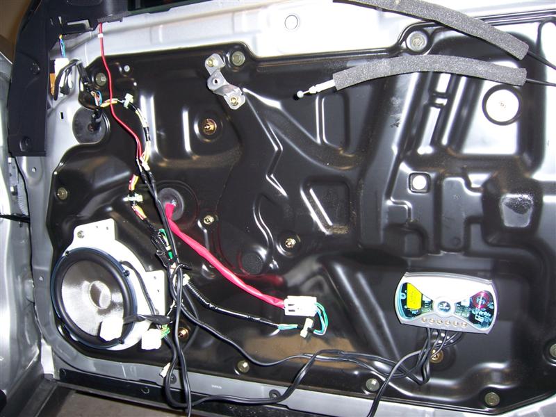

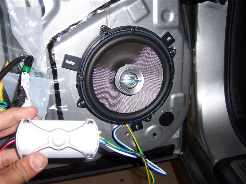

I installed these speakers today here are some pics. They sound amazing compared to stock.
Attached Thumbnails Infinity Kappa series question, please.....-100_0292-medium-.jpg   Infinity Kappa series question, please.....-100_0294-medium-.jpg   Infinity Kappa series question, please.....-100_0296-medium-.jpg   Infinity Kappa series question, please.....-100_0302-medium-.jpg   Infinity Kappa series question, please.....-100_0303-medium-.jpg
