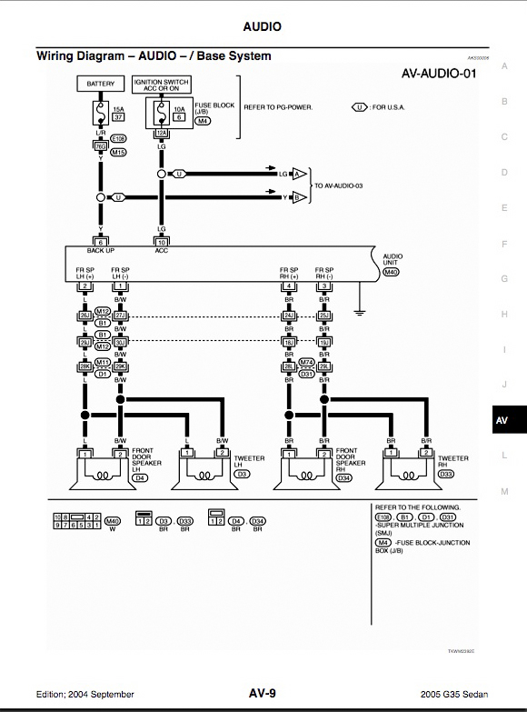

Here you are sir. Attached are the wiring schematics from the 2005 field manual.
Attached Thumbnails Quick questions on my install-wiring_front.jpg   Quick questions on my install-wiring_rear.jpg
