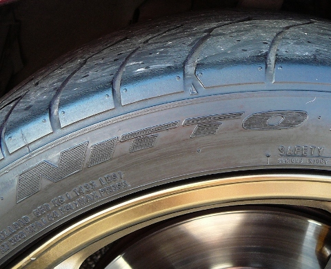

Now here's what I've been told to do. Now look at your side wall just to the point where the actuall tread stops and go around the tire until you see a small carrot '^' that points AWAY from the rim. Get a crayon, peice of chalk, shoe polish, or something to make a noticable mark on the side wall of your tire. Mark the rubber from the center of the tread, over that carrot, and down to the lettering (i.e. company logo) of the side wall. Fill those tires up to max and run a lap. The chalk should be worn down to the tip of the carrot. If it's past the carrot you need more air (i.e. tire is flexing too much at the center of the contact patch) if that chalk hasn't been worn down to the carrot you need less air (i.e. the tire isn't touching the road at the sides of the contact patch).
Now thats a coarse way to adjust pressure and worked well for me this season. But for better results get a pyrometer with a probe. That way if you got the money you can fine tune your alignment as well (you'll have a temperature profile ACROSS the contact patch). I'm going to go that route next season.
