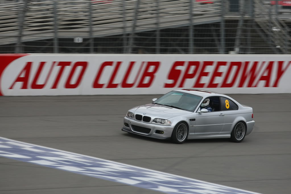

My tracked M3:
Recent track day at Auto Club Speedway:
