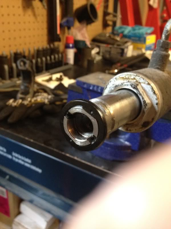

I have the same question as Andy. I was using this guide to swap out my rack and I noticed my old rack didn't have these lock plates either when I took it apart. It had a plastic spacer type thing instead. I was guessing that Infiniti has changed the design and no longer uses the lockplate. Can anyone confirm this???
Here are some pics of what I'm talking about:
Spacer on the rack (it has two tabs that fit into the grooves):

Closeup of spacer:

And here is the rack assembly diagram taken from sewellparts.com, as you can see, there is no lockplate anymore. Just that spacer:

J_Burna,
That's the same schematic the parts dept showed me. Seeing the tabs on the spacer make me feel a bit better that the no-lock-plate solution may be fine. I thought the spacer would simply be round like a standard washer. Does the spacer fit into a groove on the tie rod?

No, the spacer just fits into the grooves/slots on the end of the rack. As far as I can tell, the tie rod just butts up against it. I'll take another look at it when I get home to be sure.

I picked up my boot kits. A wrench was in the parts dept at the time. I showed them the diagram with the lock plate from the manual and neither seemed to know what it was. The wrench thought it would come with the rack.
So now the question is how critical is the lock plate? Is it even necessary?

This post: https://g35driver.com/forums/steerin...acer-sale.html shows the lock plate in the picture with a part number.
I found the lock plates sold individually here: http://www.autopartswarehouse.com/sh.../infiniti.html
I'm not going to risk installing without the lock plate.

Now I need to decide if I should get the lock plate or just go with it the way it was on the rack I removed from the car...
