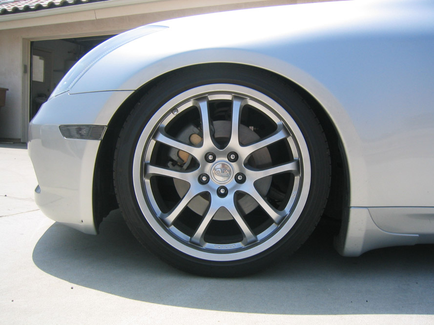

can't lower very much without camber kits..... save up a little longer and get the look you really want. Saying that, if roads are real crappy where you live than the 350 springs are probably best option.
