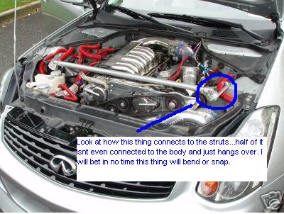

Before i seen scotts post, i was already going to bash this "carbon fiber strut bar". Look at how the thing sits in the engine bay...its a complete P.O.S.! Look at how it connects to the strut mount...it looks as though it is only held on by 2 bolts while the other half of the brace hangs off the side....anyone that designs these thing knows that you should have atleast 3 mounting points.... to prevent hinging (spelling?).
-sean

It also looks like a STB that was taken off of a 350z...and flattend then drilled with holes!

well, what do you expect for $26?!? i just can't believe that there were 7 bids on it! they must not be members of this forum....or any other forum...
